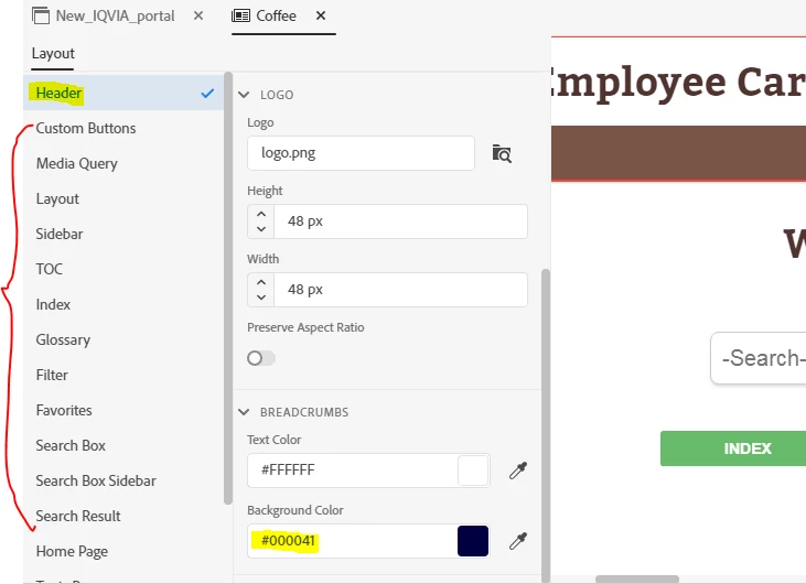

Please use the photo icon above to add a screenshot of the area you are trying to change and the setting you are applying?
Also have you tried clearing the browser cache?
Tejas Dandekar
Nov 12, 2020 11:38 AM UTC
Tried clearing cache but didn't work.

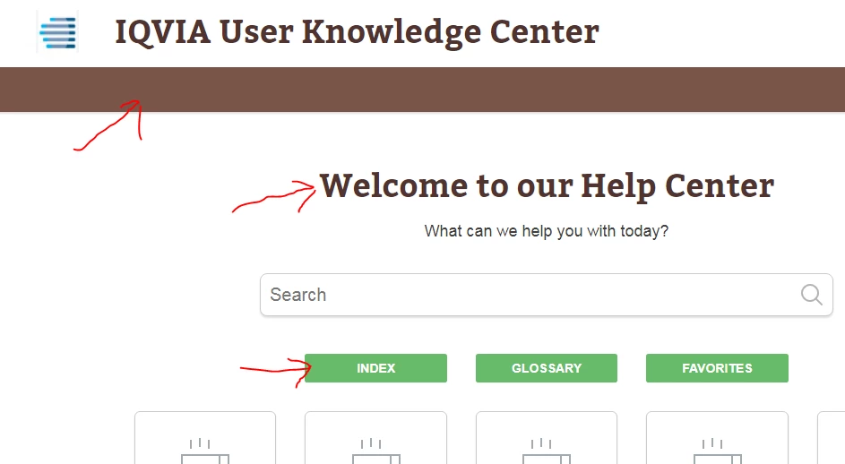

I am trying to update these areas with red arrow. The logo I could update.
I am using the below properties in RH to update.
