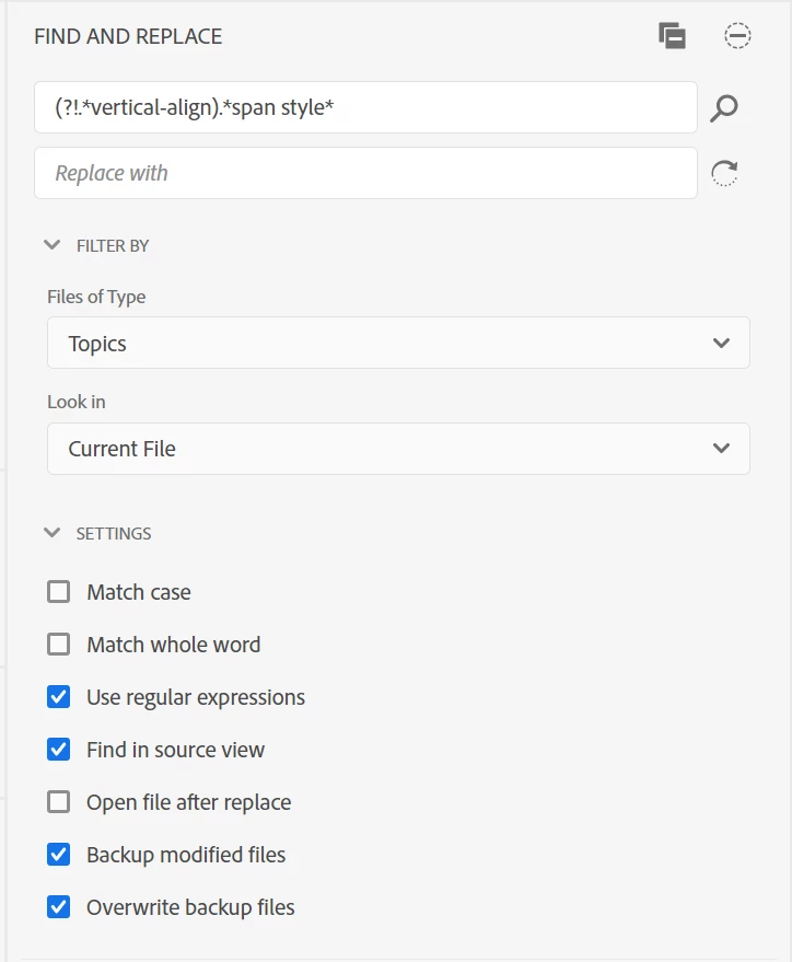

Hi all,
I am using RH2020 Update 5 and trying to fix some of my code in the source code. For this, I wanted to use a regular expression. The expression itself seems to be correct (at least, I get the desired results when using it in Notepad++), but the search in RH only keeps on running without returning any results. I tried it with the complete project and also only with one topic open.
Do I have to create the RegEx somehow different? Is anyone else having issues here?
This is my RegEx:
(?!.*vertical-align).*span style*
What I am trying to achieve with this is to find all <span style tags except those containing vertical-align (because these are my variables).
I have the following settings in the search:
Thanks and best regards
Karin

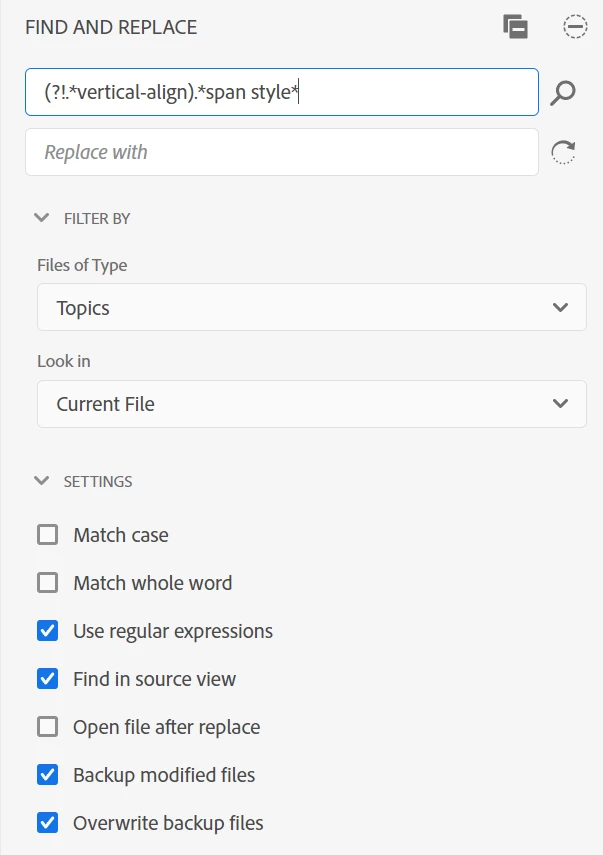

    the problem does not occur if I create a new topic with just one of the affected files. However, you can also see this effect using the sample project "About RoboHelp". In this, open e.g. the file "authoring - Importing_Linking", go to Search and Replace, enter the RegEx
    and use the following settings:
    In my case, the search in this single file did not come to an end in over 11 minutes. In Notepad++, the search within this file returned the result immediately.
    I guess you already have the sample projects, so I did not send you anything. Kindly let me know if you need anything else.
    Kind regards
    Karin
