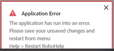

I have 15 help files to upgrade. I got to my last help file for upgrading to RH2020 and RH will not upgrade it. It works fine in RH2019. The message I get is
If I Restart RH and try again, I keep getting the same error. The only thing different with this help file from the rest of them is that the project was renamed in RH2019. However RH2019 handled it flawlessly. Does anyone have any ideas why this one may not be working? This help files does require frequent updates, so I would hate to go back to RH2019 (yet again) for one help file. I have kept all the RH2019 files so I can go back.

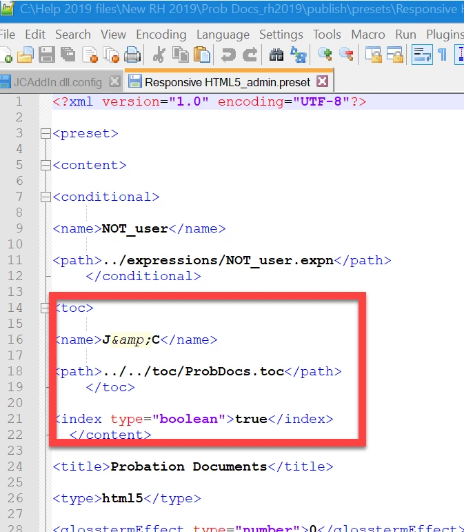

    I did some more digging. I have two presets for this help file (one for the admin and one for the users). This is what I found
    When I viewed the preset in the GUI it showed it was picking the toc ProbDocs but the html file is showing <name>J&amp;C<name>. The path is correct. I will manually change this and see what happens. Is there another place I should be checking for the TOC name?

    Okay you are correct, you can open projects in RH2019 when RH2020 is installed however the problem comes in generating them to make sure they are working. To make sure it was working right, I did uninstall RH2020. After the rename to ProbDocs.toc, everything worked in RH2019 including the generation.
    I reloaded RH2020 (uninstalled RH2019 so nothing would interfere with it) and the same error message occurred. I even checked around when I had RH2019 installed to make sure there wasn't anything else still having the J&C name and I didn't see anything.
