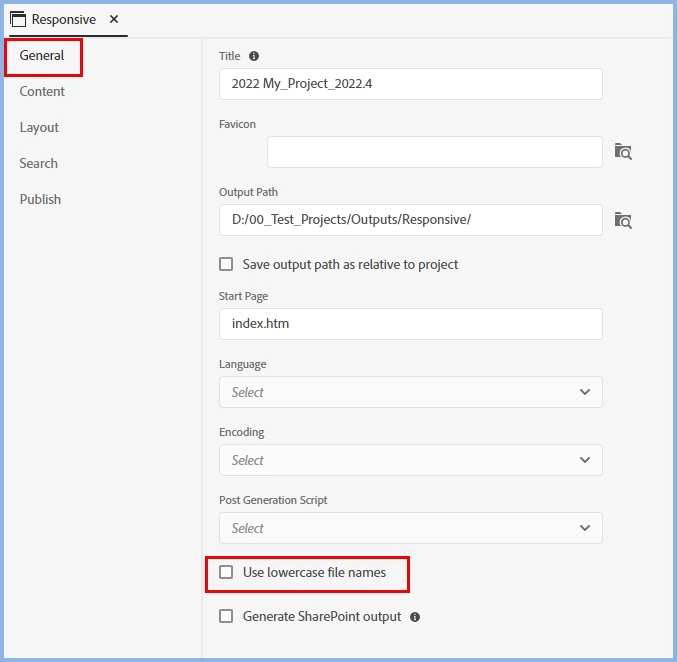

    Nov 13, 2024 8:55 AM UTC
    I think this is what you have missed. What surprises me is that RoboHelp does not change this during the upgrade. Your Classic project still exists as the upgrade creates a new project rather than changing the old one. Did you perhaps create a new preset and miss the setting?

    jas35401Author
    Nov 13, 2024 3:12 PM UTC
    No, we are actually very aware of that setting. Our path is /Company Name/help/mergedProjects/RF/rf1111. We have checked that flag so that "rf1111" is generated in lowercase. However, the "RF" before that should not be in lower case, but the generation is making it so.  In RH2015, we also checked that flag, and the "RF" remained in uppercase.
