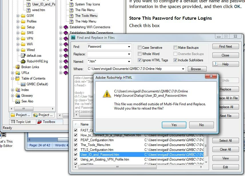

I am using RoboHelp8 HTML on a Dell Latitude 630 laptop running Windows Vista. After opening a project and then opening the Find and Replace window and searching, I made a change to one of the files (in the RH8 UI) that the "find" function found. When I went back to the Find and Replace window, I got the usual dialog that advises that the xx file has been modified and asks do I want RH8 to reload it? No matter which I click, "Yes" or "No", the dialog reappears. This did NOT happen in RH7 (on the same laptop). The only way I can get this dialog to disappear is to exit RH8 or use Task Manager and close it, which also closes RH8. What is up with this? To make it worse, the Find and Replace dialog that is behind the pop-up dialog can't be moved, and it remains on top of the RH8 UI. And clicking the red X does nothing. Here's a screenshot:

I too have come across this "interesting" behavior -  the dialog appears over and over again. The UI is not locked, however. Just holding down the Enter key when the Yes button has the focus will clear all the annoying dialogs. In my case, there are 33 dialogs that appear. I don't know if that # is directly related to my search or the # of topcis I have open, or what.
If you hold the Enter key down too long, the highlighted topic will open in whatever editor it's configured to use. And will do so multiple times until you release the Enter key. Another annoyance.
Also, on some of my find & replace operations, after the 33 dialogs, a different dialog w/ an OK button is presented. Again 33 times.
So it's a hassle, but I haven't seen that is messes up any topics.

Maybe the 33 dialogs that appeared when this happened to you was 1 for each file that you changed while the F&R dialog was open?
All - I have reported this as a bug to Adobe. Let's hope that it's fixed in the next SP release.

One way to avoid issues with the MFS&R tool is to close all topics before performing the operation. I think what happens is that because RoboHelp has a file open for editing, it somewhat freaks out and cannot deal with the file being changed behind its back. Of course, if you close all topics before attempting this, things should work more smoothly.

This is a bug because, in RH7, clicking Yes or No closed that dialog. In RH8, I have to close RH completely to get rid of it. I use this feature a lot because our beloved developers change things on the fly, and I need to search for specific things within the entire project. Too frequently, I only need to make the change in some instances, so I do it in the UI instead of in the MFS&R tool.

I'm pleased to have helped a smidge. Please note that I wasn't suggesting it wasn't a bug. By all means I hope you and others report it as such, as it shouldn't happen. What was offered was in the spirit of a workaround.
