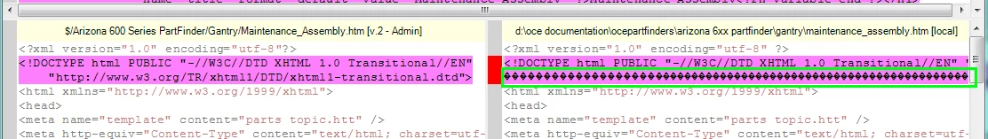

Using RH10 and RSC, my files are getting corrupted.  I am using Windows 7 64bit and I DID apply the 64 bit patch.  We have been noticing small things going wrong recently and thought it was RH10 since no problems were observed in RH9.
I know that RH10 made some network changes, could this be effecting my project?  I am pulling everything possible out of version control to avoid further corruption.  Some projects must be in Source Control.
Is anyone else having this problem?  Some corruption is local and some is remote.
