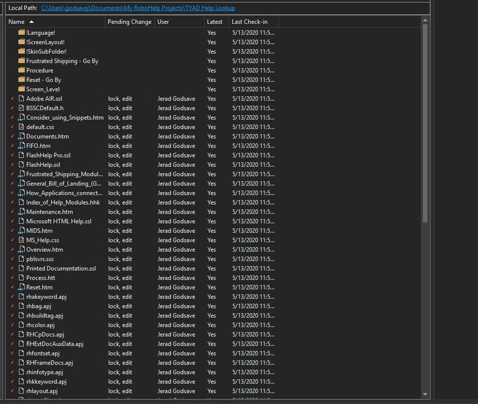

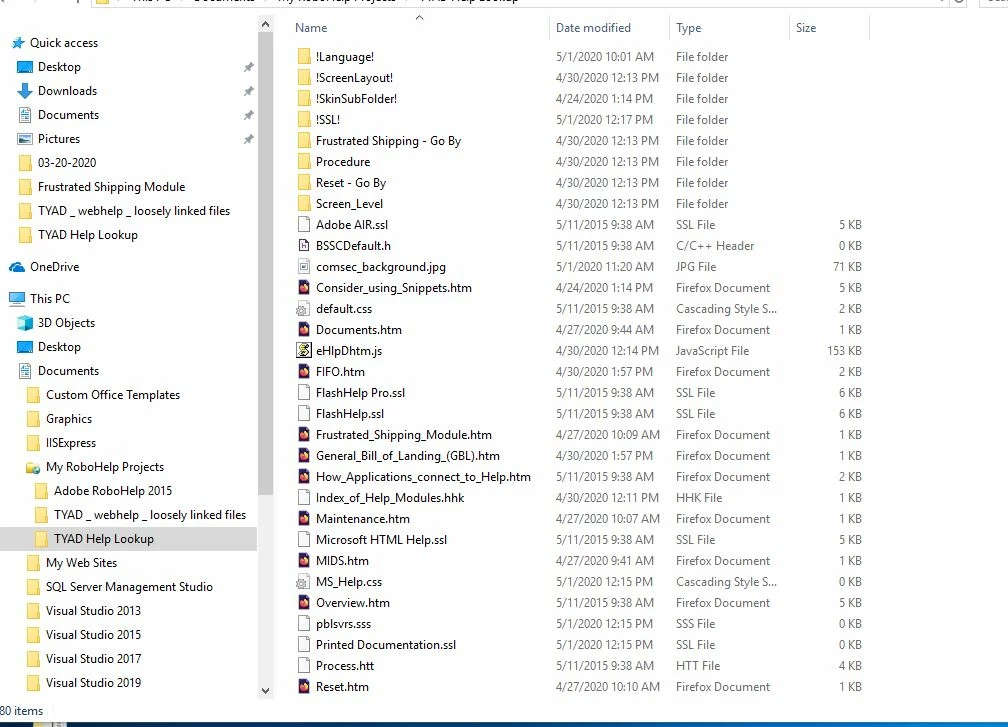

My webhelp output gets generated to my local C:\ instead of to Team Foundation Server. This means that the !SSL! subdirectory only exists on my local machine and never gets placed into TFS.
I have provided screenshots of my TFS project directory and its contents vs. my local directory (where output files get generated to).

If you're determined, you'll need to add the output folder (the !SSL! folder if I'm interpreting your last image correctly) manually using TFS itself. And you'll need to remember to manually check it out using TFS before you generate, and then check it in after you finish generating.
