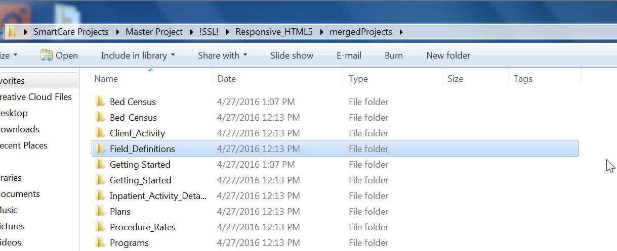

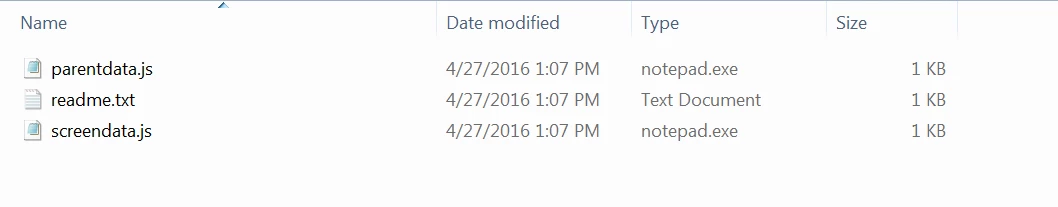

mdawn0817
mdawn0817Author
Apr 27, 2016 6:17 PM UTC
Hi, Rick,
I checked the Master Project path to the mergedProject folder. l see listings for the child projects with the correct time. I see all the image files used in both child projects. I'm not seeing topic .htm files. Should I be? In earlier generated files, there are .htm files but no files displaying in the generated help.
Can I clear the mergedProjects folder and start over? Or is there something I do from within RoboHelp to clear the previous output?
MDawn
