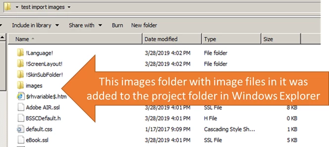

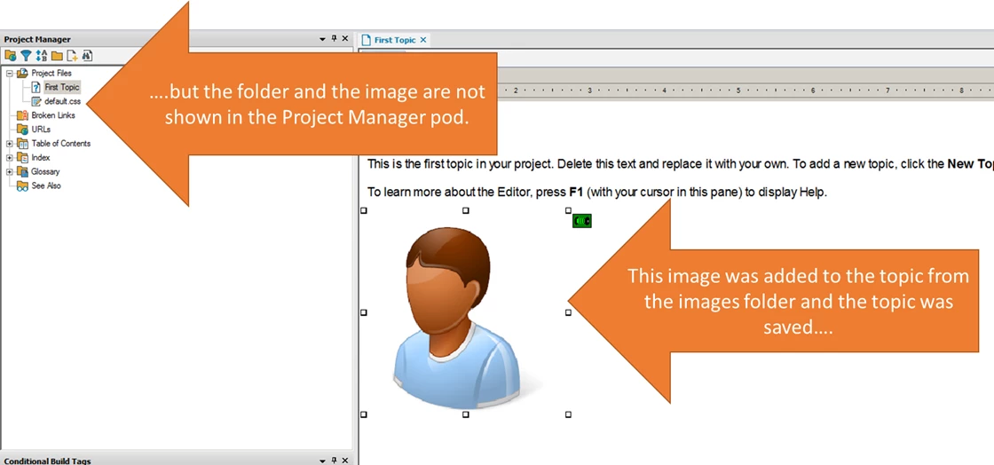

I should clarify that a folder for the images is created within the project folder using Windows Explorer outside of Robohelp, then the images are added to the topic.
I recreated the issue below. The project seems to save and publish without a problem with the exception of the image folder and images not showing up in the project manager. But then a few months down the road, the images tend to disappear from the images folder.

The first issue I note is that you say a folder was created outside of RoboHelp using Windows Explorer.
Folders need to be created using RoboHelp. That way all the internal database entries should be properly created.
What I would recommend in this case is to simply move the Images folder to a different folder. This will be a temporary move.
Once you have done this, using RoboHelp, create the Images folder where you want to have it. Then move all the images from the original folder to the RoboHelp folder.
I'd give that a go and see how well it works.
