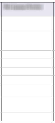

The thumbnail files were created in the output folder as you indicated. Here is a sample graphic file (image66.gif) with a graphic size  of 181x40. I had to blur the text for privacy reasons:

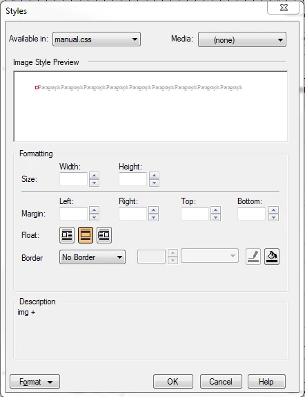

Here are the settings for my Thumbnail style:
