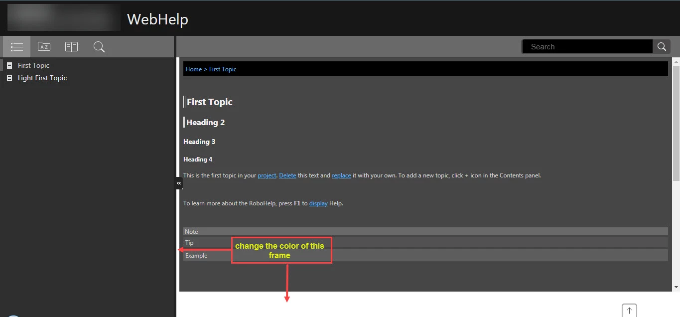

As per my project needs, I need to customize the layout of RHTML5 output.
I am done with all the changes applicable through the skin editor except the following one.
Can anyone pls help?

But, I got stuck in few things again. Please refer the attached screenshot and help me providing a solution.
Thanks!
Peter Grainge
Jul 21, 2020 8:03 AM UTC
I have an answer from Adobe.
In your output locate the folder (template\<skin name>\layout.css), towards the end of the file.
By default it will be set to a hex value. Change that as required. I have changed it to an RGB value.
In other skins you could add the div.topic to a different CSS file and add that to User Assets so that it is applied whenever you generate. That option is not in the charcoal grey skin so you will need to make that change whenever you generate.
s_wengAuthor
Jul 21, 2020 9:06 AM UTC
Thanks Peter, this is exactly what I did in the layout.css placed at (template\<skin name>\layout.css). I made the changes in hex value only like this:
div.topic {
  background-color: #464646; }
  div.topic div.functionholder {
    display: none; }
  div.topic a.to_top {
    display: none; }
But I believe as the changes are done in the output folder, so we need to replicate it everytime when we generate, hence, making it a temporary solution to the problem.
So, it would be helpful if we get a permanent solution to this problem.
However, I am trying with Azure Blue. Will post here when done.
Thanks a lot for your help!
Jul 21, 2020 1:01 AM UTC
If worse comes to worst, perhaps you could customise the Azure Blue skin to match the charcoal grey colours (I think it's the same otherwise), except that the User Assets section is correctly available. Then you could add a custom css file which contains a div.topic selector with the correct background colour.
Peter Grainge
Jul 20, 2020 7:45 PM UTC
That may be the only answer but I have made some enquiries so let's see if anything comes back.
It would be helpful if you could post what you changed.
Peter Grainge
Jul 20, 2020 2:36 PM UTC
I have tried everything in the skin editor and some CSS changes but no luck so far.
s_wengAuthor
Jul 20, 2020 7:36 PM UTC
Yup I tried too but couldn't get anything!
I was wondering if there is any js/css file that we can modify accordingly but couldn't find any in the source. However, if I change layout.css inside the output folder of the skin... I am able to change the frame color.
So, this way I got this temporary solution but I need a permanent one.
Peter Grainge
Jul 20, 2020 2:11 PM UTC
Is that Charcoal Grey?
s_wengAuthor
Jul 20, 2020 2:32 PM UTC
Yes it is.
