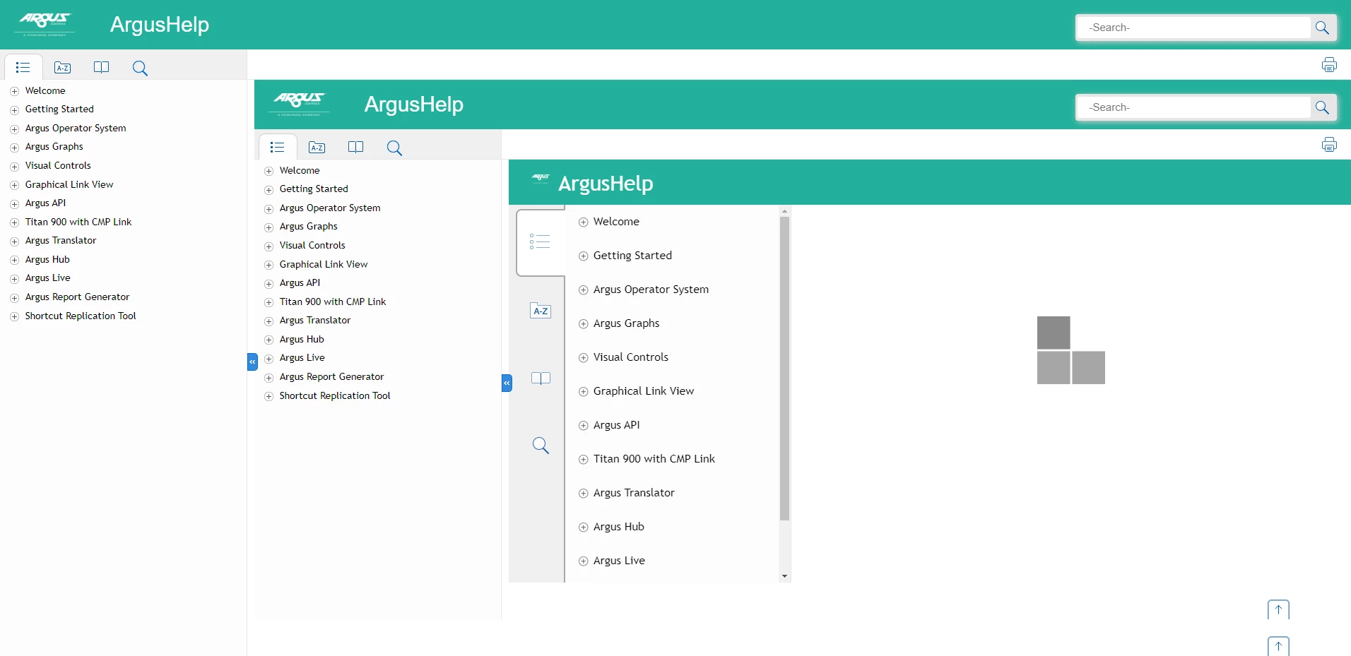

Then I tried to open the help with just the default call from the software, and the main page now does this:
It seems to be recursively pulling the topic and I don't know why. I know this is a separate problem, but any thoughts on what this could be? Or should I start a new thread about it?
I changed the Start Page parameter under the General tab of the Responsive HTML5 output. Other than that, I haven't changed anything else recently. Is this a skin problem? Output problem?
