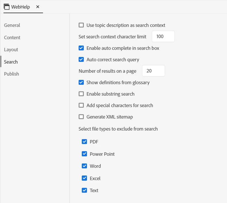

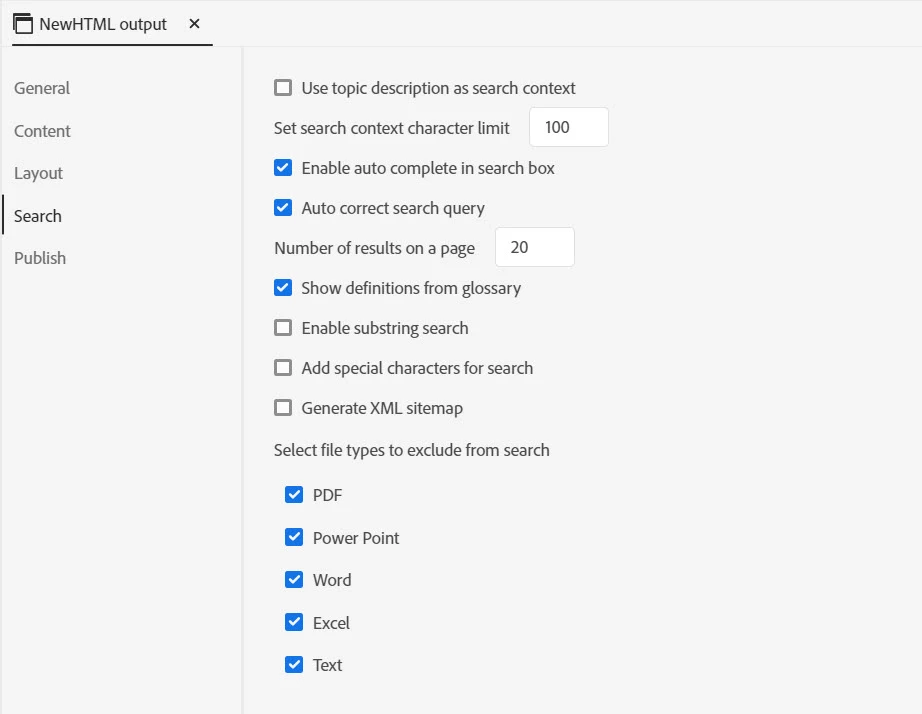

I saw related posts about this issue here and done the following things to resolve the issue.
  • Used default css from a new project.
  • Set all options under "select files to exclude from search."
  • Changed skin.

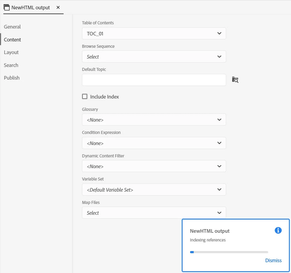

One thing seems to work is - if I Create a new TOC and add only a couple of topics. But as soon as I add all topics, output won't generate.

Next, I Added few topics at a time and generated output. As long as I am adding just few topics to TOC (About 10 at a time), Output is generating.
But when I added all topics to TOC at one time and ran output, it got stuck on indexing references.

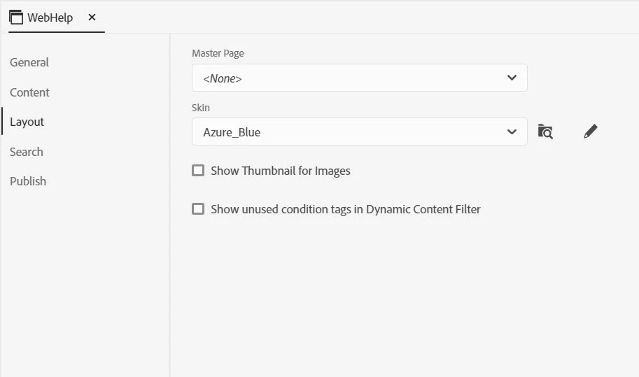

Cgbn5987897
July 16, 2020

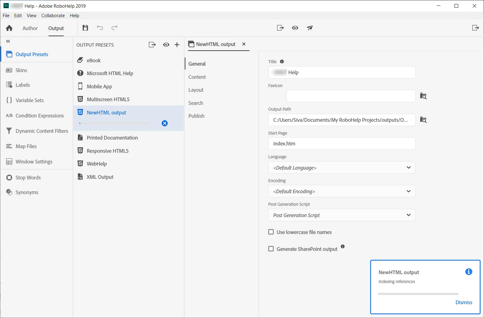

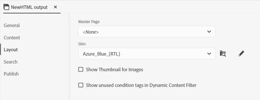

Thanks for your suggestions Jef & Peter. Earlier I was using a duplicated preset. Now I have created a new preset but the issue still persists. 😞
Screenshots of new preset

That was to be my next suggestion. 🙂 Where Jeff is going with that is to try creating a new preset, not a duplicate.
If that doesn't change things, try changing your start page to just index.htm.

Cgbn5987897
July 16, 2020
Hi Peter,
Here are the screenshots. I selected a different skin but got the same issue.
Peter Grainge
July 16, 2020

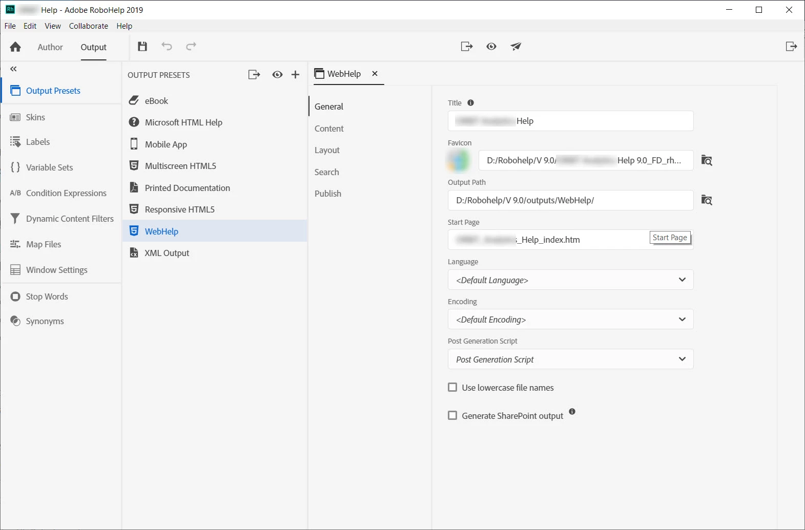

Please add a screenshot of your Output Presets using the photo icon above where you reply.
Open the properties and try selecting a different skin.
