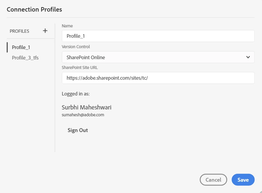

In the video I see that login has not happened successfully. After login is successful RH tries to find the site and then Save is enabled.

I do see the screen as https://forums.adobe.com/servlet/JiveServlet/downloadImage/2-11021629-1730050/pastedImage_1.png but only from my office. At my client’s office (which is a government network with controlled Internet access via a forward proxy), the Microsoft login screen closes, but the Save button remains greyed out.
