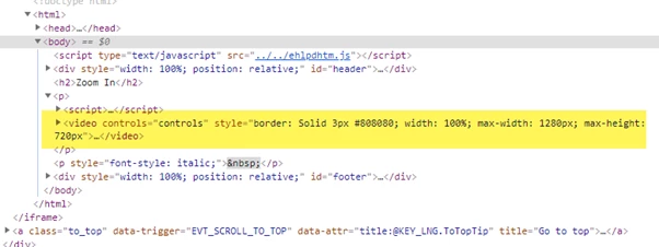

The only workaround I found after hours of trial and error is to manually edit to topic source to include a <style> tag with the width set to 100% and a max-width set to “1280” as shown below. It does not work if you put max-width in the video tag outside of the style tag.

At the browser, I can see that RH 2017 automatically translates the above to use the same <style> tag at run-time, with the width set to 100% and the “max-width” set to the preferred size, as I have to do manually now in RH2019.

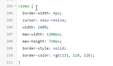

It's been a while since I looked at this problem (I switched back to using RH2019 Class). Update 7 has fixed many of the problems but this one remains. However, I have found that if you create a stylesheet entry for <video> such as the example below and it will force the videos throughout the project to be responsive and display at the correct size in the output:
You can't use to UI to define this tag this so you have enter in source code view.
The Source view of the topics will still show the video at the smaller default size but at least it works in the output.

I have found that to fix the small static size shown in the Author view for all videos in a project converted from 2019 Classic to 2019, you need to perform a global search and replace of all HTML files in your project to remove width="100%" (in addition to adding the custom video tag to the CSS as shown above).
