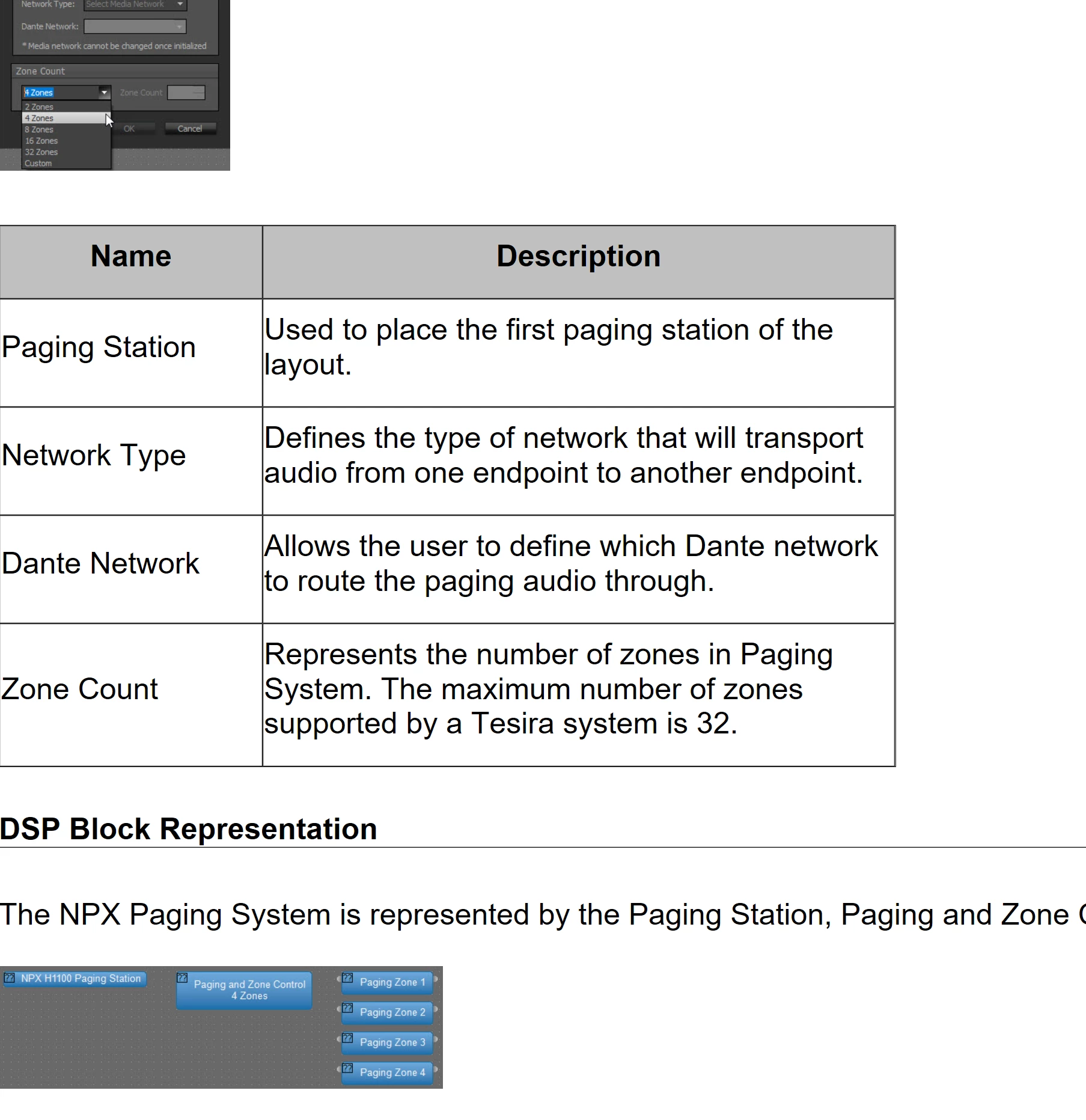

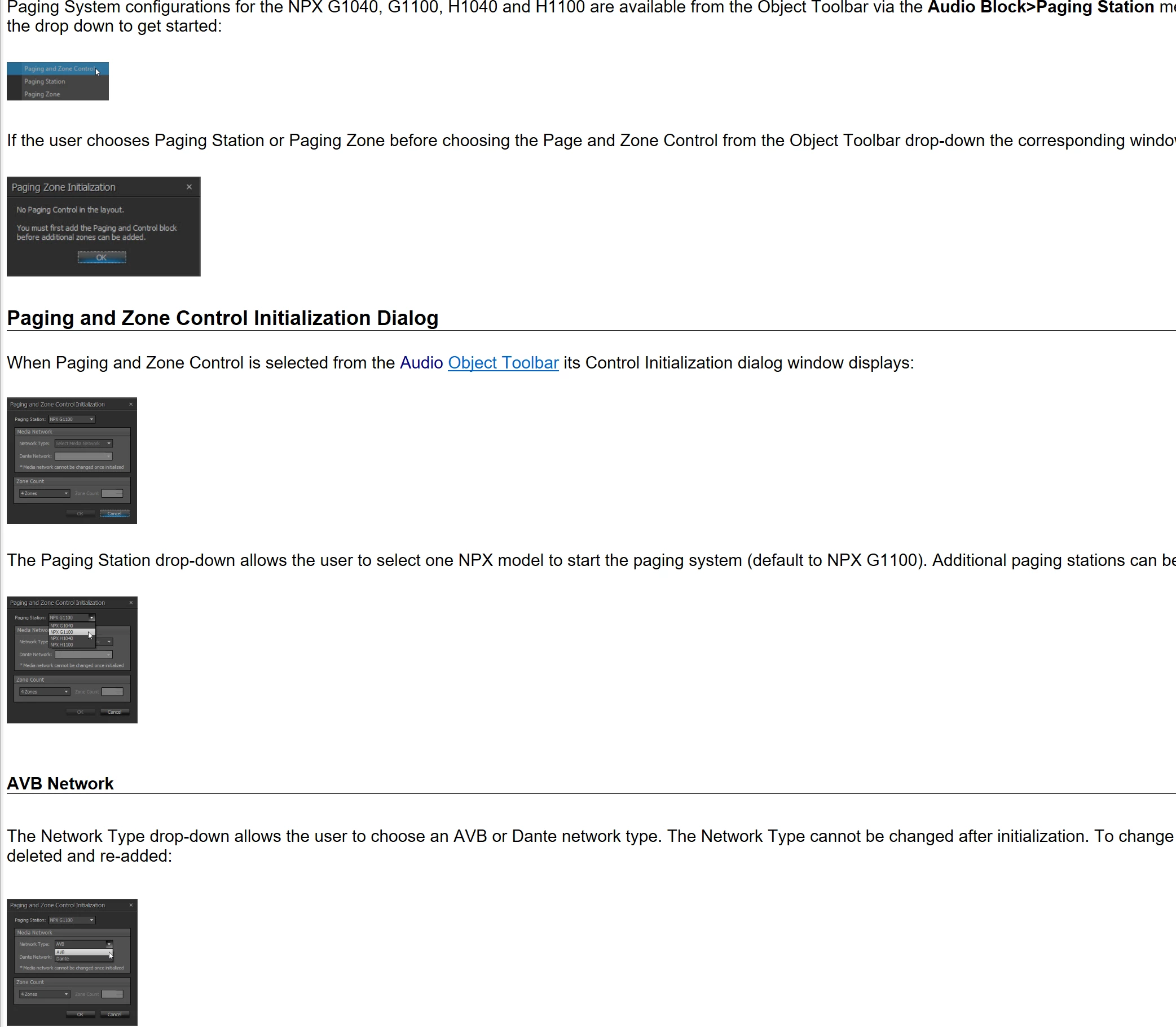

    Does your stylesheet have any entries in the Image Styles section with a % width defined? Or have you set a % width on individual images? That might cause the issue. Usually by default the chm window opens as a small size, and a % width means the image will resize to that percentage of the available chm window size as necessary.

    I am putting this out here again in case anyone can help. I have spent three hours with a software engineer trying to figure out why the 2020.7.0 Microsoft html (chm) output makes all of the images in the file smaller, even though shape of the image are the same.
    Image styles were not created before doing this project. It has been around for years and upgraded to 2020. I have other web helps that are doing the same thing (they were created in 2019 new UI and then 2020 and output was fine for 2019). Many of table is this files are being scrunched up as well.
    Small:
    For more perspective, here are the images compared to the images. Way out of proportion. Also, the table is is also scrunched in from the sides. In RoboHelp it's wider:
    Thanks in advance,
    Julianna

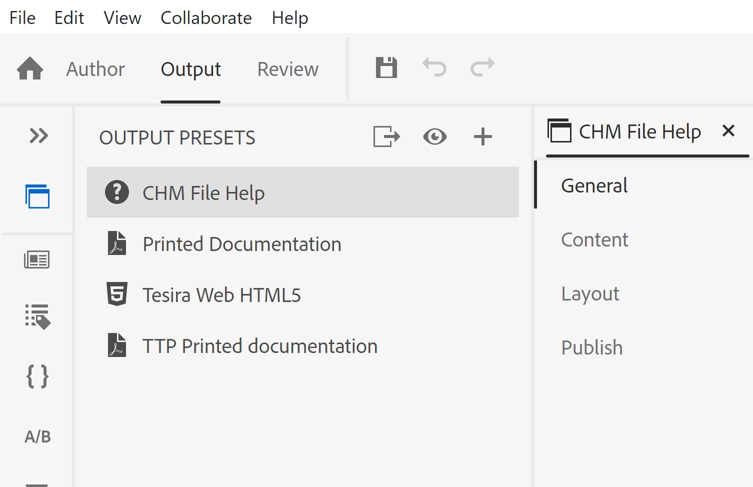

    Hi Peter,
    I wish I knew that I could add the Microsoft HTML! My output is working fine now.

    Sorry about the confusion over the version. 2020.7.0 was never released and I was thinking of 2020.0.nnn
    On upgrade the name of the SSL in Classic is applied to the preset in the new UI. If you click the + icon you will be able to add a new Microsoft HTML output.
