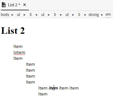

    If you're importing or pasting content from Word documents, you'll get a lot of HTML tags you can't necessarily see in RH. This can prevent options showing up that you expect (because you're not in the HTML tag you need to be).
    I recommend using the hierarchy breadcrumbs at the top of each topic tab. They show you the hierarchy of tags your cursor is currently inside. In this example, my cursor is inside an em tag, which is inside a strong tag, which is inside a list item (li) tag, which is inside an unordered (bullet) list tag, etc, back to the body tag.
    When you want to apply a condition to a list item, I would recommend clicking on the li in the breadcrumbs, which will correctly select the entire list item, then apply the condition tag.
    When you drag the mouse to select, you are likely selecting only the content of the list item, not the li itself. That would explain the bullet still appearing but not the content.
