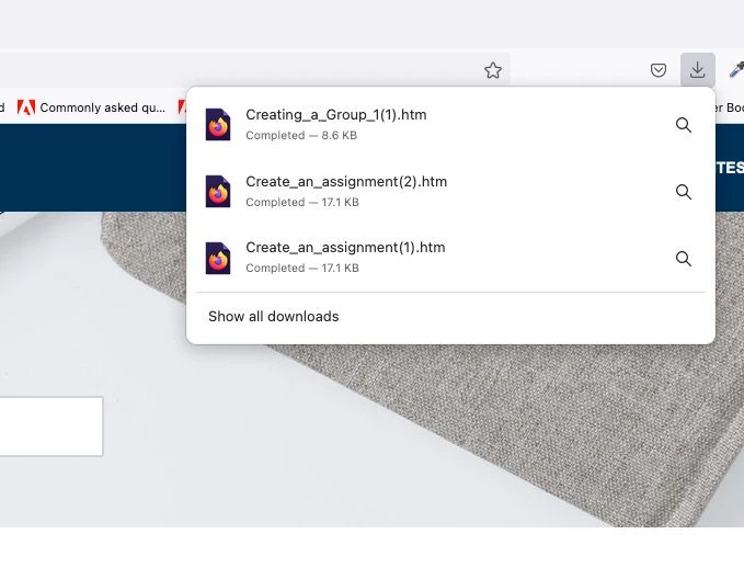

I have a strange issue with the last deployment of RH project to AWS.
The links of the topics are being downloaded instead of being open i the browser.
Do you have any idea how to solve it?
Steps to reproduce:
go to: help.english.com
Open Pearson English Connect
> Get Started
> open any Topic e.g. Before Begin
Expected behaviour - link opens the topic
Actual behaviour: The HTM file is being downloaded

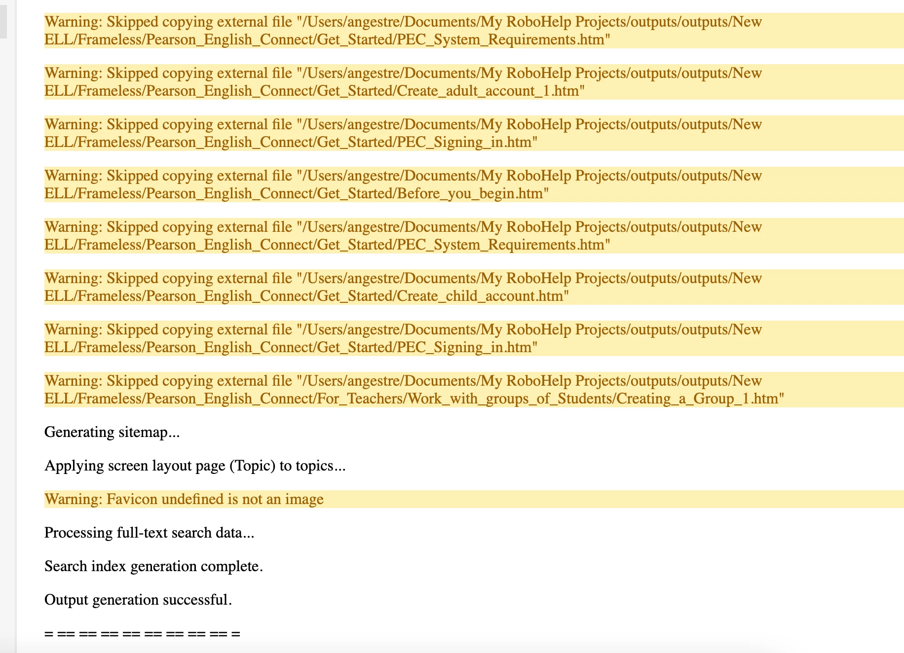

The generatesd output shows some errors, but preview works well on local machine

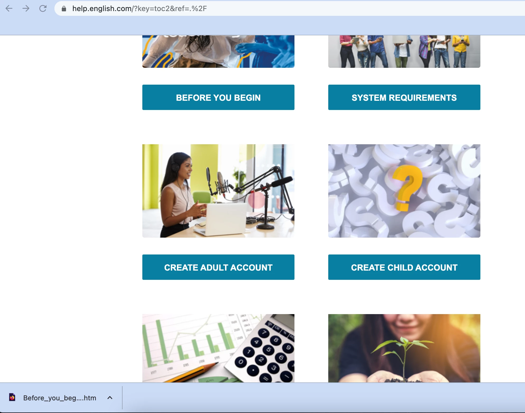

    June 27, 2022
    Yes, thats correct @Peter Grainge When I open a topic from a tile (ToC2 - screenshot above, e.g. Before you Begin, System Requirements) the files are being downloaded in PDF.  I don't have access to a listed ToC (ToC with links only) now, as the topic doesn't open.  This is my help site, where the issue is still visible:  help.english.com
    I already talked with devops, who said that in AWS there is no option to set someting link that (downloading files) and I got a problem.

    Don't use the preview - use your browser outside of RH and pull up the index file of the locally generated output - does it still want to download the pages instead of opening them? If so, the issue probably has something to do with those links Peter was talking about. If you get them fixed up and are able to generate without errors AND it will launch locally just fine - THEN you will know it's an issue at the AWS end of things.

    When I am looking into those files in the project tree looks fine, I looked into "Find and replace" option and it directs me to related topics part, where we added html links - we added them as released in help.english.com domain - so that caused ithe errors in the output. I removed related topics links from the topics and the output was successfull, no warnings! but the uploaded content behaves as before - instead of opening it downloads the content...
    So I will check AWS now, hoping we can find the reason.

    What those yellow warnings are telling you is the link is an absolute link to your local drive. For obvious security reasons browsers cannot access your local drive, thus the links to them do not work.
    Your task now is to find those links and I have found it best to search on just a small part of path.
    With that said, the behaviour I would expect is not to download the files as that goes against browser security. Maybe AWS works in a different way?
    I suggest you fix the generation first so that there are no errors. Then offer up a couple of chickens in the hope that fixes the issue. The fact the file names are the same gives some hope.

    The output will work locally as you have access to those files. The message has told you those files have not been uploaded, that's the difference.
    You need to use Find and Replace set to Find In Source View and search on just parts of the path in the warning.
