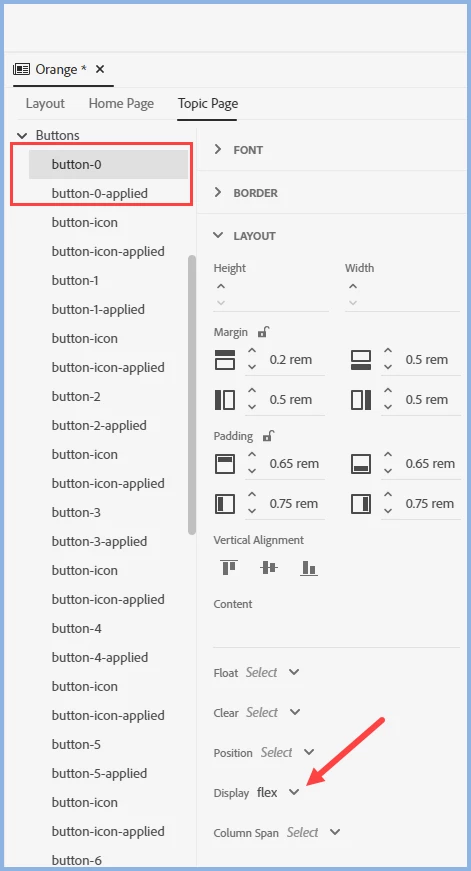

    I changed the Output > Layout > Display setting from Flex to None. The bookmark and filter buttons display as expected in the Skin Editor preview, but in the output the filter button is still missing. I also tried different display settings for button-2 since the filter icon appears linked to button-2, but that didn't make a difference. I returned the button-2 display setting to the original setting: flex.  This seems to be similar to issues previously reported with the changes showing in the Skin Editor preview but not in the output.

    Try changing Flex to None for both buttons. I haven't tested it but believe that is the correct solution from another issue I had. Certainly in the Skin Editor it hides the button.

    Nov 10, 2021 5:35 PM UTC
    An update-- there may be a bug affecting this:
    I removed the expand all / collapse all button from the Orange skin Topic Page settings by selecting button-icon > Background  and button-icon-applied > Background (immediately under the first set of button-0 items), and I removed the reference to the *.svg file for each in the Image Path (expand_all.svg and collapse_all.svg). These changes removed the Expand/Collapse All button, but unfortunately the Filter icon at the far upper right was also removed alhtough no other changes were made. It seems the removal of the references to the expand/collapse all .svg files shouldn't have had that effect, because the Filter icon .svg files are listed under the button-2 section. In fact, the default Filter.svg and Filter2.svg are still listed in my project but the Filter icon is no longer displayed in the output. I can look into reporting this as a bug.
