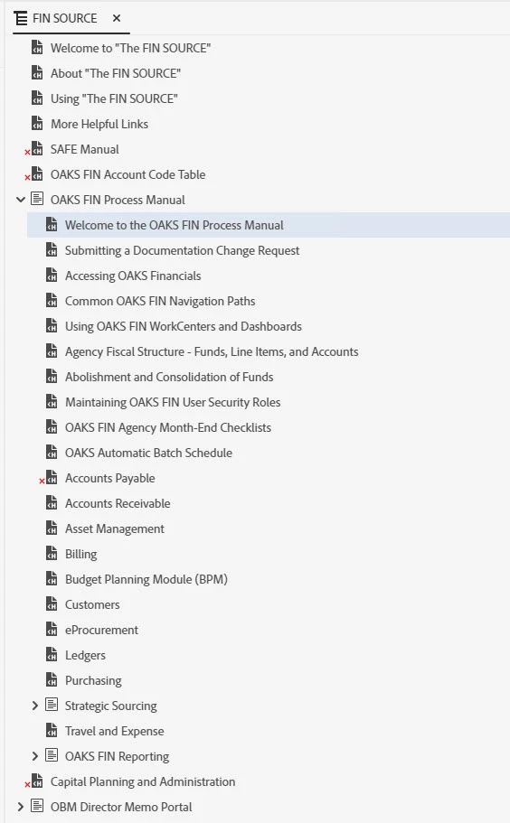

    Understandable. It's quite a large site with a lot of projects - my apologies for it being so complicated. We haven't upgraded all of the projects, our current focus was all of the projects within the OAKS FIN Process Manual folder. None of them are still set up as child projects - I've attached a screenshot of the TOC in case it helps.
