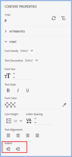

    When you have a problem, look at the hierarchy breadcrumbs at the top of the topic. You'll probably find you're inside a span, or b, or some other HTML element that's an inline element, which can't be indented (imagine trying to indent a single word in the middle of a sentence in Word).
    In such a case, use the hierarchy breadcrumbs to click on the first available block element, such as a p. That will select the entire element, and side panel will update and you should have the indent/outdent buttons available again.

    Thank you for your help., Is much appreciated. I was  working on this issue yesterday. sometimes the indent icons are available and work as expected then other times they are not available. I creared a new topic and it has several images that I needed to indent. Some indent as expected while others do not. I have used the tab key in the past to indent a single line of text. I am trying to determine why sometimes the indent icons are available and sometimes they are not.

    Adobe have confirmed to me that the tab key has never allowed indentation. In Classic versions it indented the whole paragraph.
    The code I gave you is for first line indentation only. To indent a whole paragraph, click in it and use the Indent icons. Click in rather than select.
