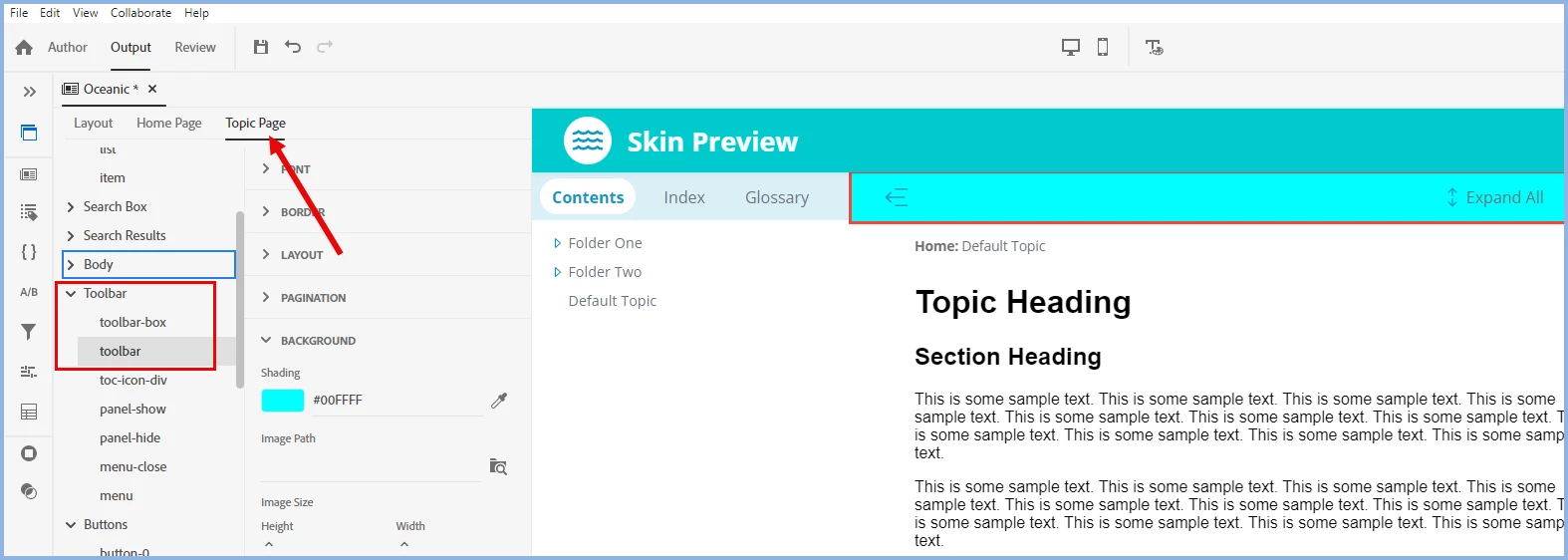

I am needing to change the color of the light blue bar at the top of the skin (right below the dark blue bar).  Does anyone jknow what the specific item I would need to edit would be under the Topics tab?   I've clicked on each item found and i never did see the light blue bar highlighted .  I'd love to be able to make some edits to that if possible.

    Skins are now templates and I think that one is Oceanic.
    In the editor you need to get the preview to show the page to be edited. In this case it is the Topic Page. Then you need to expand the sections on the left and click on the items until you find what you want. As you click on items, they are highlighted with a red border.
    In the case you need to change two settings the bar is in two parts. That is because some users may want the part over the TOC, Index and Glossary in a different colour. Here I have changed it to turquoise.

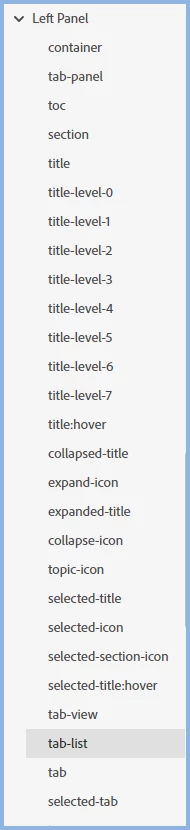

    The part over the left panel as it is known is here. Tab-list is highlighted and that changes the other part.

    I was in the Topic Page - I just wasn't ever finding the Tab-List to to show with the red around it to let me know I was selecting the correct "thing" to edit.  I'm going to go and look at it now to see if that will take care of it.  Thank you, Peter 🙂
