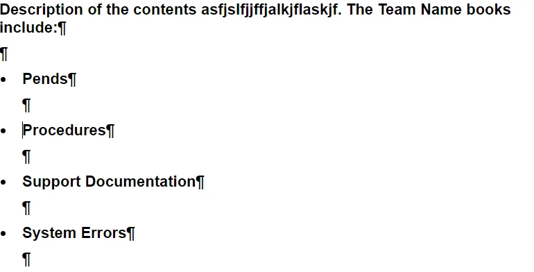

Hello.  I have a converted classic (2017) project; the 2022 version is Version 2022.2.22.
I have noticed that some (or many) topics have an extra paragraph mark in author view, but this paragraph is not there in preview mode, and the cursor in author view also indicates that it is not there.  In the example below (author view), the blank paragraph after the word "include" really is there.  The rest of them are not.  If I have my cursor after the "s" in the word Pends and press the right arrow, it skips the blank paragraph as if it wasn't there, and goes right to the P in Procedures.

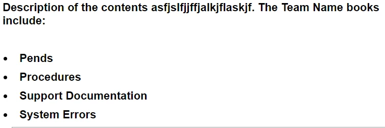

The preview of the topic looks correct:
Is there something I can do to make the author view appear correctly?  The extra paragraph not appear after every item in a list - it does in this topic, but there are others where it is (seemingly) random - the first 3 items in the list might have no extra paragraph and then the 3rd and 4th do, for example.  Preview is correct and shows no blank paragraphs.
thanks!
Chris
    WoutJacobsCorrect answer
    Nov 12, 2024 11:14 AM UTC
    Does the blank space disappear if you remove the (superfluous) p-tag within each <li>-tag?
    e.g. <li class="bulletspace"><p><b style="font-weight: bold;">Pends</b></p></li>
    => <li class="bulletspace"><b style="font-weight: bold;">Pends</b></li>

    Nov 19, 2024 12:20 PM UTC
    The extra paragraph mark is correct, if confusing.
    It represents the closing tag. So when you have p tags inside li tags, you'll get a paragraph mark for the closing p tag and another paragraph mark for the closing li tag.
    So if we have the following html:
    <li><p>My text</p>
    </li>
    Imagine a paragraph mark replacing the closing tags, like so:
    <li><p>My text

    This is very helpful and prevented me from having to ask another question. 🙂
    It's easy enough to remove the extra paragraph marks since they had no impact on the output, and it looks cleaner in author view.  But I noticed extra paragraph marks for at the end of drop-downs as well, that were part of a list, so this response explains that as well.  I'll expect those to just be there as something to get used to.

    Nov 12, 2024 3:53 PM UTC
    Yes it does.  Thank you very much!  I can remove those as I edit a topic.
