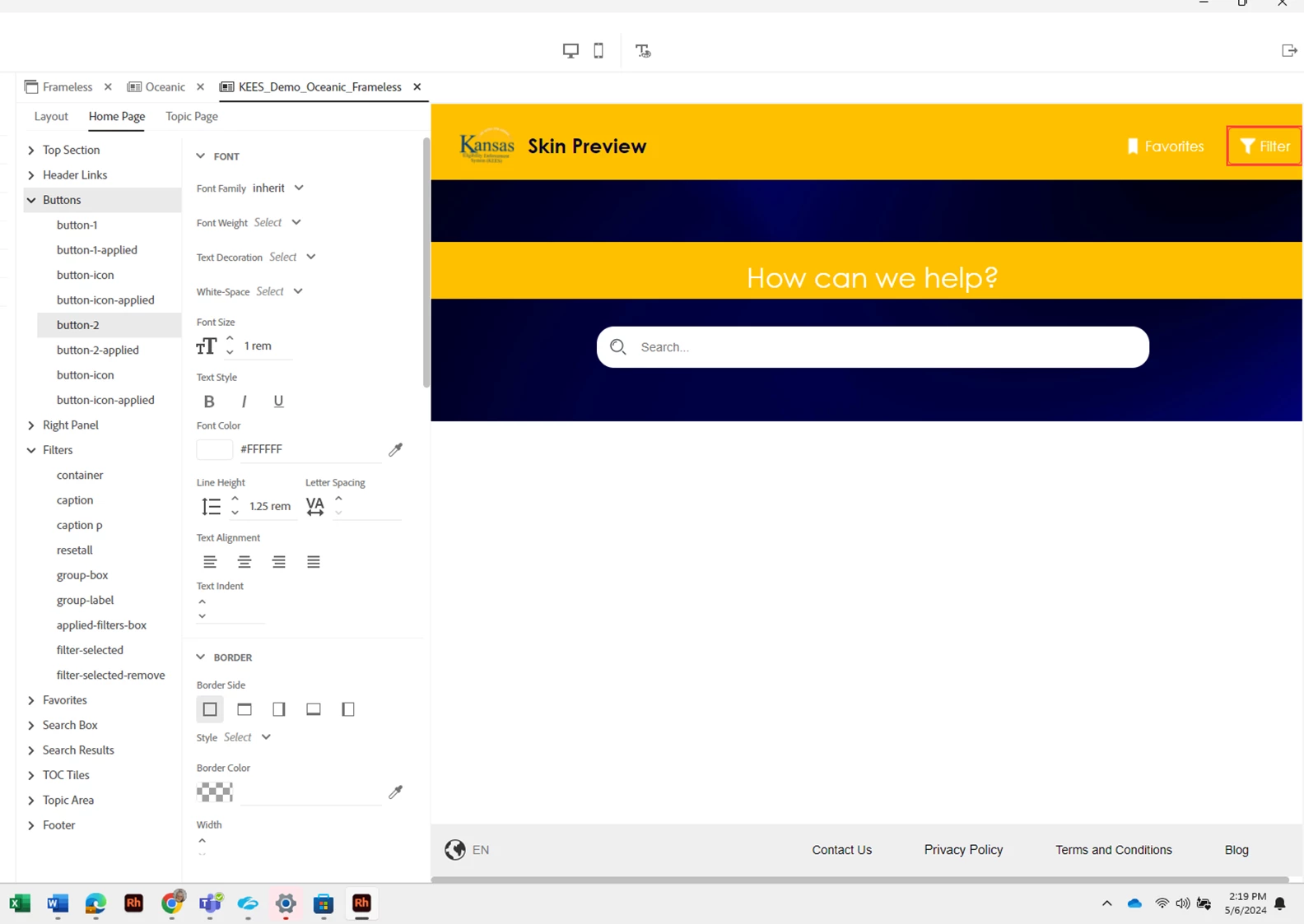

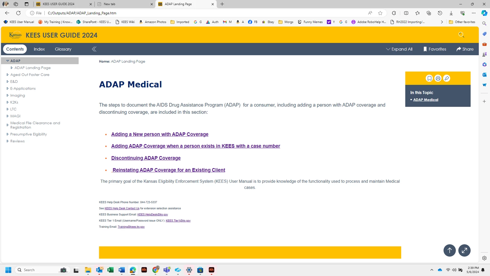

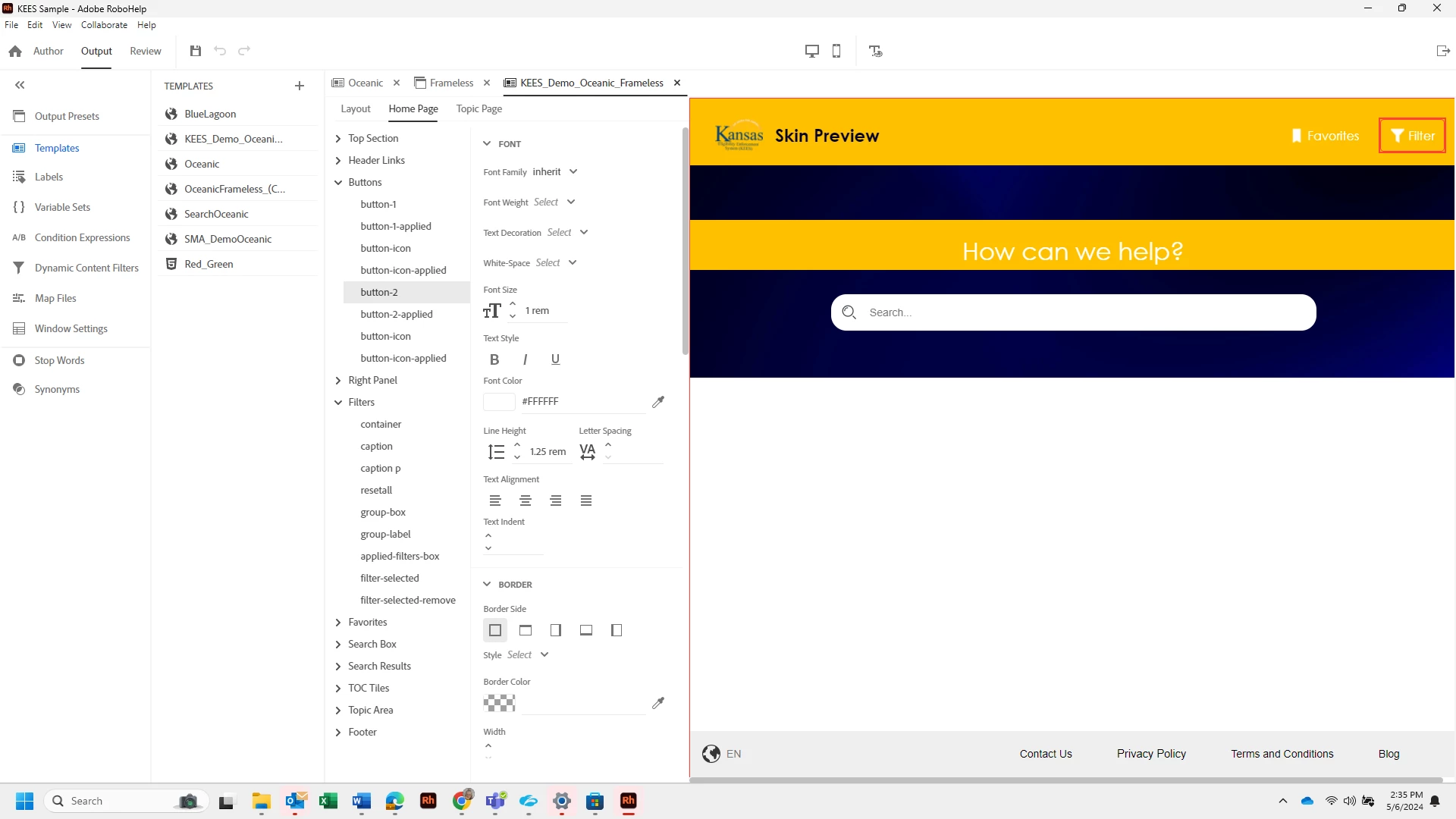

I am having an issue where the Filter opitions are not showing on my Frameless Oceanic Output.  It all looks right in the skin editor, but once I generate and view, it's gone.  See screenshots below.  First screenshot shows the Filter option in the skin editor and the 2nd screenshot shows the actual output where Filter is missing.  oes anyone know why or how to correct this?

    May 6, 2024 7:54 PM UTC
    Have you fooled around with the size of the page in the browser? I find that some responsive elements appear & disappear at different screen sizes - you can simulate a lot of that by grabbing a corner and expanding/contracting the topic.

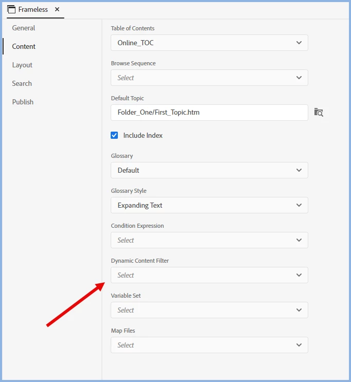

    Have you selected the filter in the preset?
    ________________________________________________________
    My site www.grainge.org includes many free Authoring and RoboHelp resources that may be of help.
    JenniR_12
    JenniR_12Author
    May 6, 2024 7:38 PM UTC
    Hi Peter.  I think so.  I can see it showing in the preset.  Is there a specific place (that I'm not finding) to tell the Filter option to show up?  It's showing up in the livepreview on the preset.  (screenshot 1 in my OP).

    May 6, 2024 7:41 PM UTC
    It's not showing on the topic page either on the output but IS showing on the live preview in the preset.  It's just missing.  The Favorites and Share options are showing on both the preset and the output.  Just the filter is missing.
