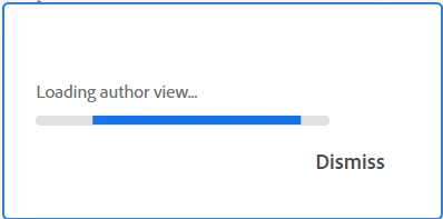

Hello.  I have just converted a classic (2017) project to 2022, and there are a couple topics that aren't loading.  The "loading author view" message appears, nothing happens from there.  It gives you an option to dismiss the Loading author view, but nothing happens when I click on it, and I can't work within the topic or any other topics.  Will it eventually load?  (Right now it's been 24+ minutes.  Previously I'd exited RoboHelp and reopened it, with the same results).  Is there a limit to the file size of a topic?  The topic in question is 3051 kb.
Has anyone experienced this and is there a way to get it to load?  I'm not sure if it eventually will; I'll keep it open longer as I work on other things.
thanks!

    I am seeing roughly the same times and having looked at the content, the issue is clearly way too much in one topic.
    I think the way I would structure it is to create one topic per month and then have a topic like your existing one where the link opens the chosen month in a new page. That way the user clicks on a link, the topic opens in a new tab that they can close when done. The original page will still be there for them to choose the next month that they want.

    I think the lag will go some time after loading. I wouldn't like to say how long after as this topic is crazy long. In over twenty years on these forums, it is at least ten times bigger and maybe 20 than anything I have seen reported.

    I suspect the dropdowns have a part to play in this. The topic I have with dropdowns and tables is slow to open but it has way more of them and does not take as long as your topic. Against that, it has nothing like the amount of content. The fact that no one would print it is irrelevant, it is the indication of size that concerns me. Have you seen any web page that would print to that many pages? I think you are right in saying you need to break it down.
    The increase of the file size in 2022 is simply the code behind it.
    I doubt Update 5 will make any difference to this issue  Don't wait for that re the other issues. Post them in new threads.

    I don't think there is an official limit but 3mb is one massive topic. I have some topics that take a while to load but I am talking about say 5/10 seconds for 200kb.
    Upgrading does not overwrite the Classic project. How big was the file there?
    Do you still have a Classic output? Open that and go to the offending topic. Don't actually print it but start the process to get a count of how many pages.
    Let us know that first.

    I do still have classic for a while longer - the topic is actually 3051 kb in classic (my fault for checking there when I originally posted) and 3531 kb in 2022.  I didn't make any changes to it so I'm not sure why it's that much bigger in the 2022 version.  It takes about 3 seconds to load in classic; in 2022 it eventually loaded after 40+ minutes.  And once it does load, there is lag trying to navigate in it.  Is this just the way RoboHelp 2022 performs?  That a massive 3 mb topic takes less time to load in classic than a 200kb file takes to load in 2022?
    With all of the drop-downs open, print preview says it would be 524 pages.  No one would ever print it or open all of the drop-downs at once however; it's kind of a repository of data by year/month, so users only open the particular drop-downs they need.
    I'm guessing the only solution will be to break it up into multiple topics, but if there is another solution or if it's a known issue that 2022 is slower, it'd be good to know.
