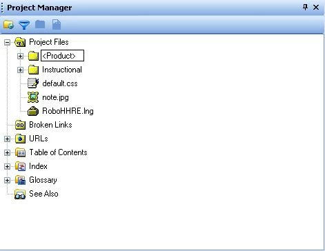

As for your baggage folder, this is not an actual folder. Are your referring to the folder icon in your Project Manager? I can't remember in RH7, I think it was the same as RH8 which by default baggage files at the bottom of the list of Project Files with a baggage icon. For example:
You can get the old style RH6 interface back by clicking on the Toggle icon as indicated below:
