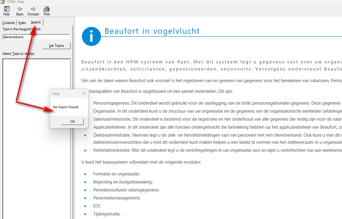

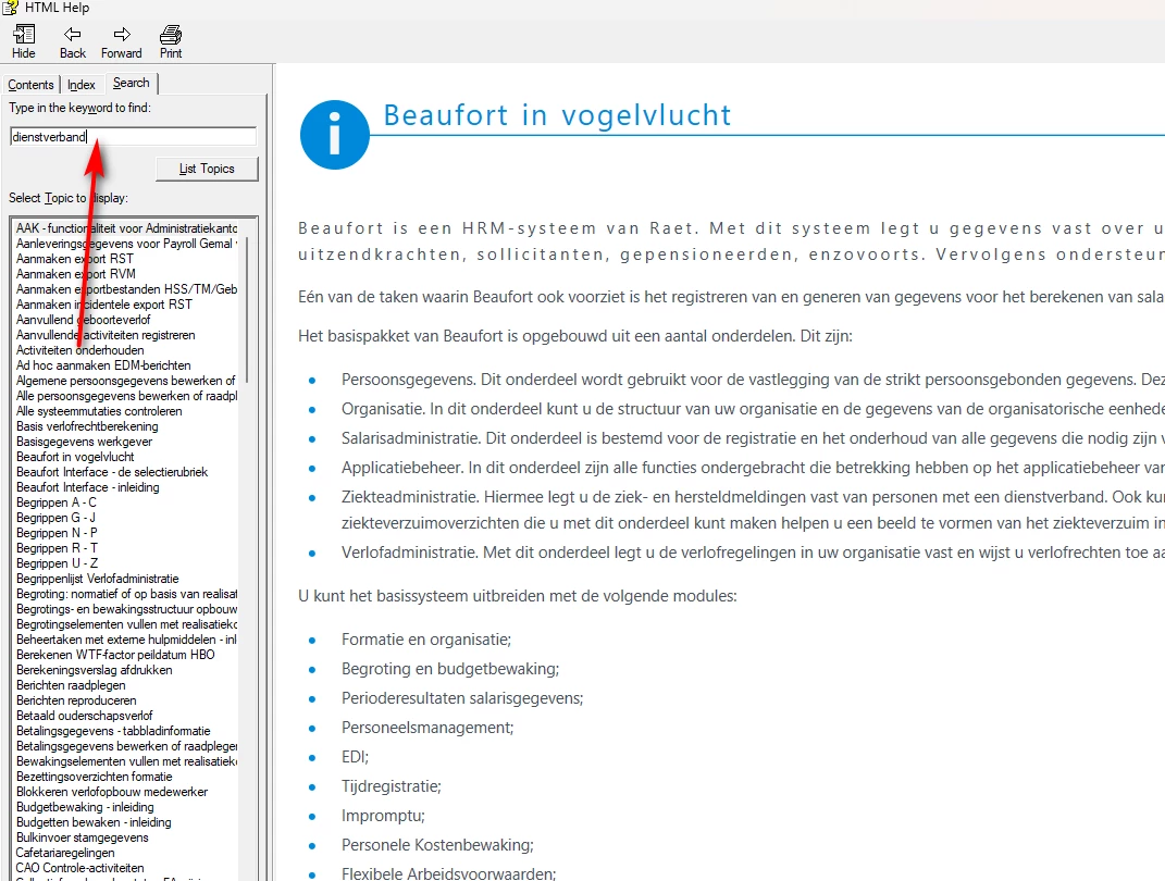

We create old skool helpfiles in CHM format. Still working fine for our purpose but after a reinstall of robohelp (due to a new image) the search on keywords in the newly generated helpfile does not give any results anymore.
Same project just before the reinstall worked fine. See also the attachments.
Any idea what is causing this?
