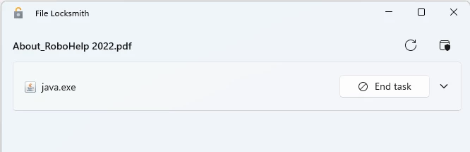

The "About RoboHelp" project generates the PDF but I can't open it as it remains locked by the Java process. This doesn't happen in my project, but the same "Applying PDF Settings" dialogue box remains and the Output progress bar continues to scroll endlessly.
Frameless generates fine in all projects.
I've uninstalled and reinstalled Java and still get the same results..
