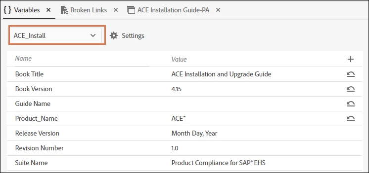

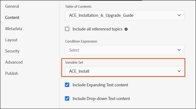

I have several Variable Sets defined in Default.var and assigned to PDF output presets. The Variable Sets work correctly:
  • They appear correctly in the Variables editor.
  • They can be selected from the Variable Set dropdown in an output preset.
  • The output generates successfully.
  • The generated output uses the correct values from the selected Variable Set.

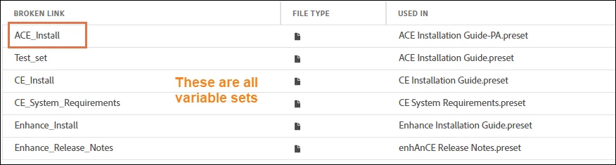

However, RoboHelp reports the Variable Set assigned to each output preset as a broken link.
Output preset with Variable Set defined
Defined Variable Set
Broken Links list

I removed the Variable Set from the output preset in RoboHelp and saved the preset. RoboHelp removed the <variable> element from the preset XML.
I then selected ACE_Install again using RoboHelp's Variable Set dropdown and saved the preset.
RoboHelp itself recreated exactly the same XML:

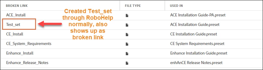

Test with a completely new Variable Set
To eliminate the possibility that the programmatically created Variable Sets themselves were the problem, I performed another test:
  1. Created a brand-new Variable Set named Test Set manually using the RoboHelp UI.
  2. Assigned Test Set to the existing output preset using the RoboHelp UI.
  3. Saved the preset.
  4. Ran the broken-links report again.
Variable Test_set created normally also is broken link
The manually created Test Set was also reported as a broken link.

  • Variable Set reference in Broken Links report: reported as broken
Has anyone else seen this behavior in RoboHelp 2026?
Is there another project reference or setting that the Broken Links report expects for Variable Sets assigned to output presets, or is this a false positive in the Broken Links report?
