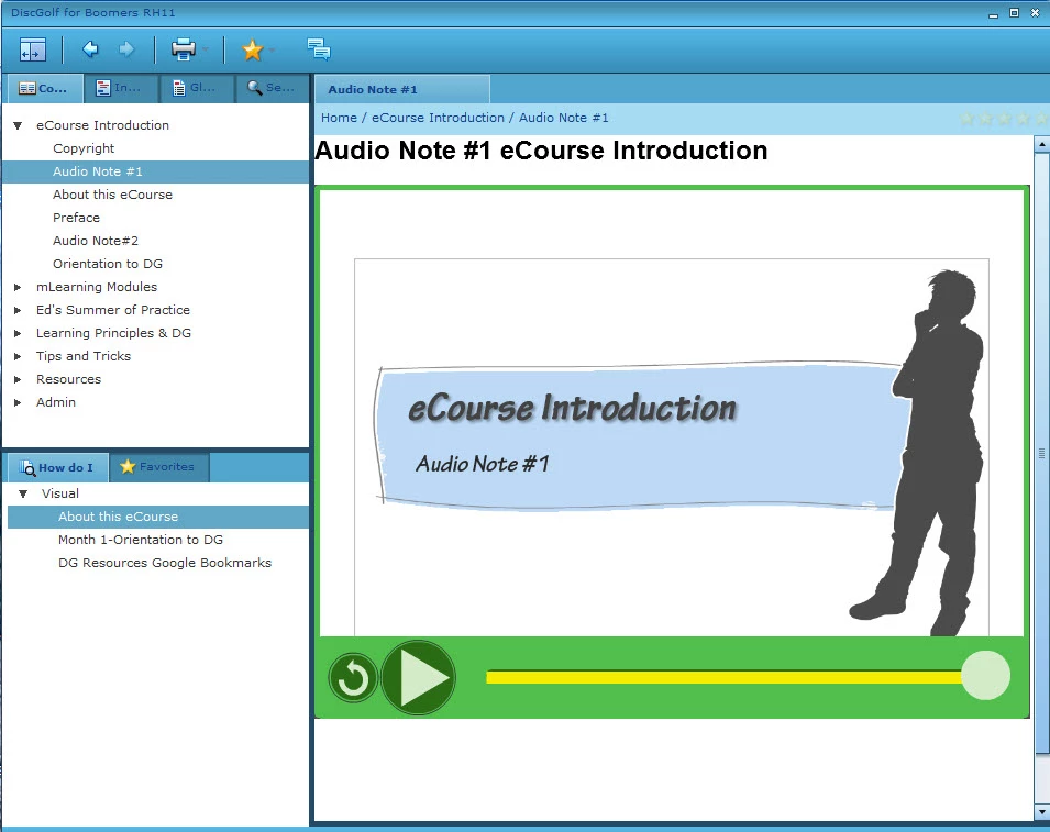

    I just did the following test. My poject uses RH 11,
    • Built AIR help w 3.9? and installed the AIR module.
    • When the system prompted me for to update the AIR installer, I choose "update later".
    • Exited the APP and made a tweak or 2 to the content, changing the skin, 1st topic and CSS, then rebuilt the AIR file.
    • When the system prompted to update to 4.0? (did not write the build #), I updated and installed the AIR file. Attached is a snag of the result.
    Suggestion:
    DL another installer and check your content settings.
    The SWF you see in the pic is a 1 slide CP7 project Audio note. Tested, Index, Glossary and Search. All work.
