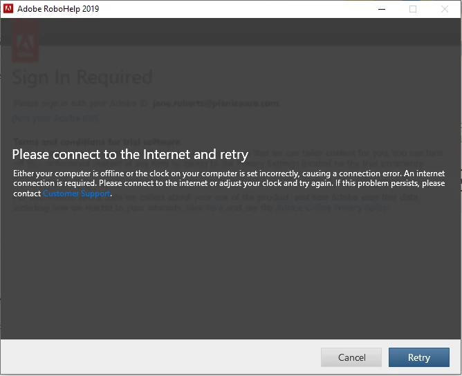

RoboHelp sign in dialog blocking on No internet connection. Cannot start software
Just today for some reason I have this problem where the sign-in dialog (which appears every day) appears but when I click sign in I get this:
It doesn't work trying to access the app directly or when accessing via opening a file. My internet is connected, everything else is working (including sign in to Acrobat), my clock is set correctly, everyone else's is working correctly in the office.
Has anyone ever seen this before or know why it's suddenly doing this today and have any way around it?

    Well Adobe support sent me many of the suggestions that were in the articles posted above.
    I have a deadline to validate someone else's doc for today, so, I concentrated on that validating from their output instead of carrying out the changes directly in RoboHelp... i.e.,, I didn't press on with finding the solution before getting that done. Was planinng on looking deeper into it this afternoon. Was still working on it this morning, on the offchance, without doing anything, I tried to log into RoboHelp and it's now working again....
    I, therefore, do not know if it was on their side or my network was just being weird (nothing else stopped working yesterday) or what. Total mystery. I wish I knew what had happened but the essential is I have it back 😄
    However, this is the info I got from Adobe. I had already done the top list and the hosts file check mentioned in the second list to no avail...yesterday:
    "The issue that you are facing occurs due to network and domain security, hence I would suggest you to please follow the below steps one by one and see if it works.
    1. Turn off the Antivirus
    2. Turn off the proxy or firewall
    3. Close the Captivate Sign in Window.
    4. Sign out from the creative cloud and close it.
    5. Check the date and time on the machine, it should be correct as your time zone.
    6. Verify if you are connected to VPN, if yes, please disconnect it and try to sign in.
    If you still get the error message, follow the below steps.
    1. Close the Captivate Sign in Window.
    2. Sign out from the creative cloud and close it.
    3. Go to the location:- C:\Program Files (x86)\Common Files\Adobe\SLCache
    4. Delete all the files inside the SLCache Folder.
    5. Navigate to this location:- C:\ProgramData\Adobe\SLStore
    6. Delete all the files inside the SLStore folder
    7. Go the location C:\Windows\System32\drivers\etc
    8. Open the Hosts file and see if there is an entry like adobe.com
    9. If yes move the file to desktop and remove the entries related to adobe or adobe URL and save the file move back to the same location.
    10. Try to sign in.
    If the issue still persist, try to login in Local Admin Account with the help of your IT team and see if it works there. If you still get the same issue whitelist the ports/URL given below.
      1. activate.adobe.com
      2. adobe.com
      3. adobeid-na1.services.adobe.com
      4. ccmdl.adobe.com
      5. ccmdls.adobe.com
      6. cmdl.adobe.com
      7. ims-na1.adobelogin.com
      8. ims-prod06.adobelogin.com
      9. interaction.adobe.com
      10. lm.licenses.adobe.com
      11. na1r.services.adobe.com
      12. oobe.adobe.com
      13. p.typekit.net
      14. prod-rel-ffc.oobesaas.adobe.com
      15. prod-rel-ffc-ccm.oobesaas.adobe.com
      16. sstats.adobe.com
      17. swupdl.adobe.com
      18. swupmf.adobe.com
      19. use.typekit.net
      20. www.adobe.com
      21. prod.acp.adobeoobe.com
      22. All port 80 and 443"

    I've had a problem consistently with it not leaving me signed in. Every day for months I've had to sign in (even if I tick remember me or keep me signed in or whatever it is)... I get so used to it. Maybe this problem comes from that problem.

    Hmm, if it's just you then it could be some firewall settings on your machine. Was this working fine before? Oh, hang on - it's RH2019 - it could be the issue in this helpx article - https://helpx.adobe.com/tech-comm-suite/kb/deprecated-internet-explorer-10-with-ims.html - with Adobe's activation servers manifesting itself with another message. See if any of that helps.

    Yeah I'm working remotely and not connected to the VPN so it's got to come from my computer I guess or from them changing something since yesterday or a Windows update (possibly to do with this article) and yes it's RoboHelp 2019 with classic on. It was the most feasible way we got it to work with our existing body of doc when we converted from Doc-To-Help and I ran into problems when further trying to migrate to the newer versions of RoboHelp. Might have to look at that again if this doesn't get resolved.
    I will try the steps on this article thanks and see if that helps. I didn't see there was a Windows update last night, but maybe there was and something changed.
