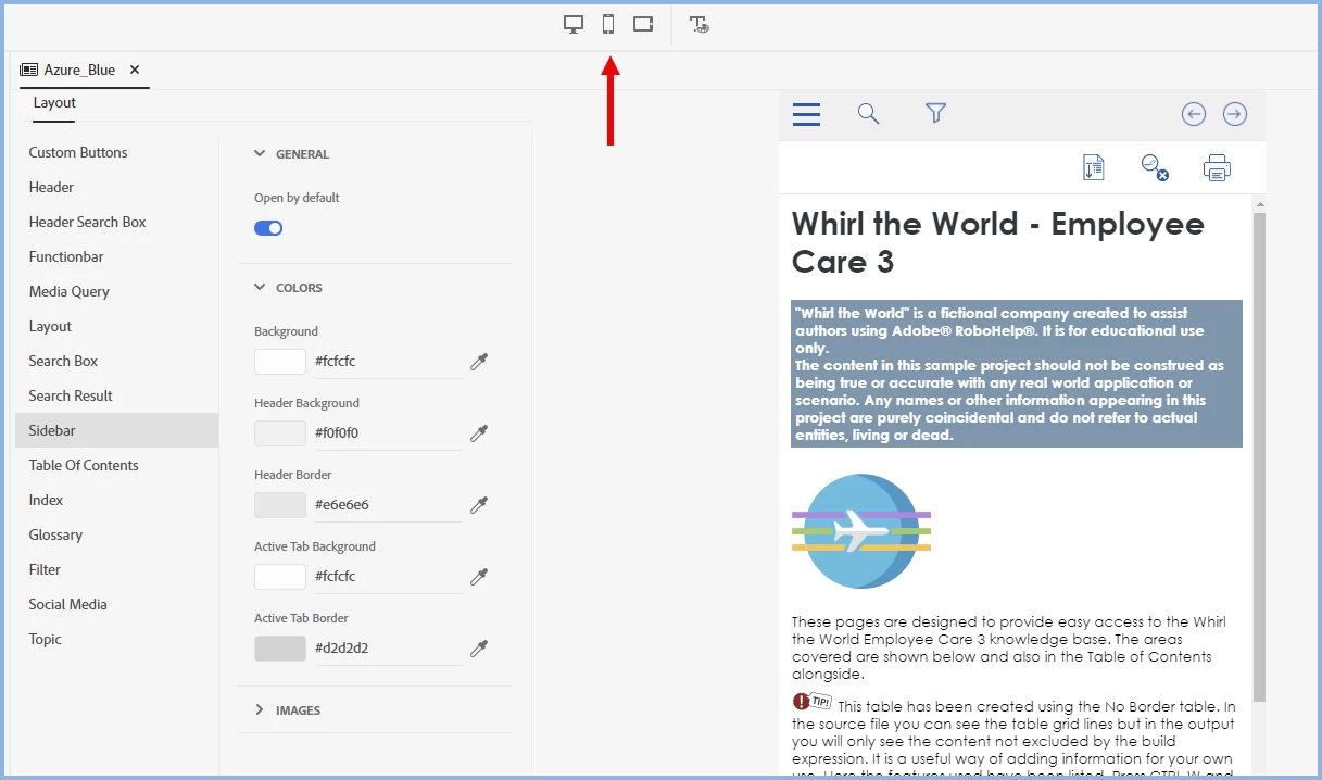

    I understand why you don’t want to change to frameless but that is what is making your customisation of the TOC difficult. Responsive skins have very little built in customisation.
    First question is are you changing the customisation of Azure Blue to the phone settings? Looking through the settings Sidebar seems to be the most obvious but even that does not allow a width setting.
    There is only option that I can think of to try and that is to go behind the scenes. What you do is reduce the browser window size so that it switches to phone size. Then right click in the area and select Inspect. That will show you the code and you may find a width setting.
    What you then do is put that setting into a CSS file but then you hit the next issue. In Frameless there is an option to upload that when generating. I can’t see the same option for Responsive.
