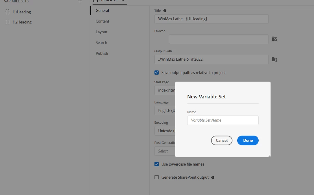

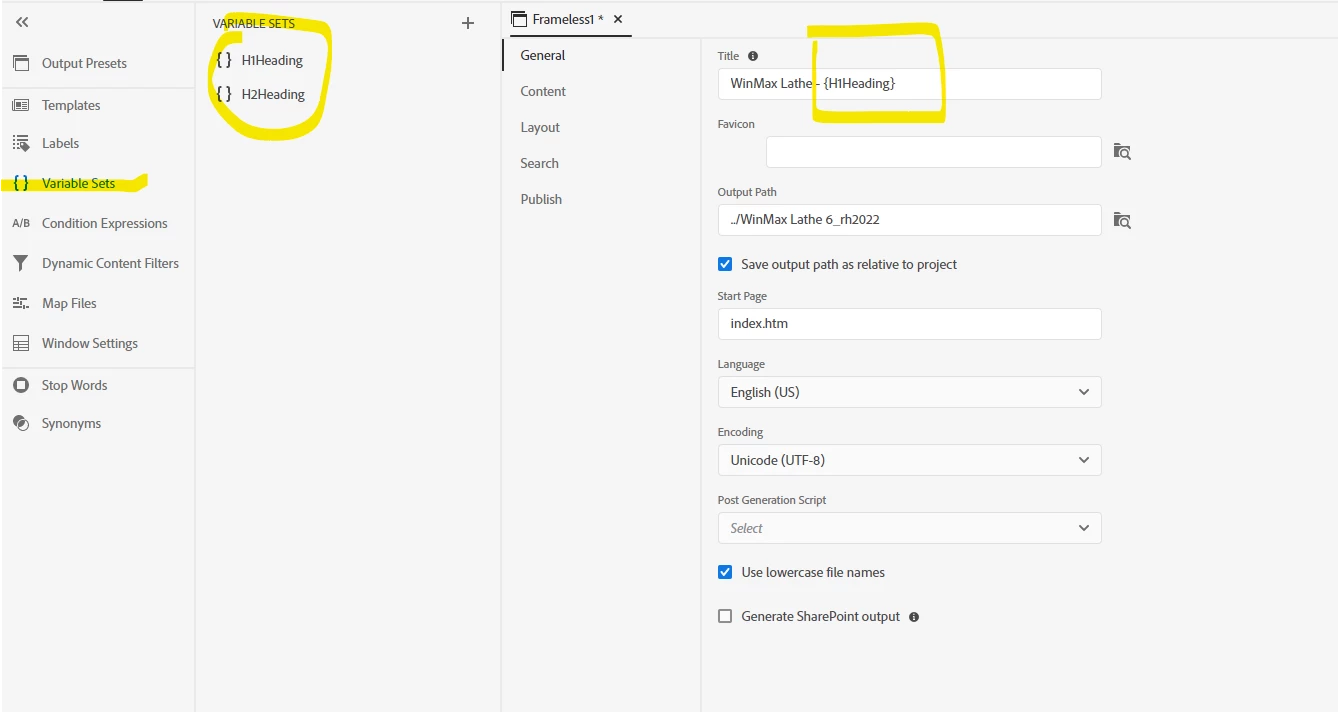

We want the Page title on our html pages to be the H1 or H2 heading of each article. We highlighted the headings created variables and then added them to the title field before exporting. something like {TitleHeading} . However when exporting the page title just shoes the {TitleHeading} not the actual variable and says "Variable not defined" . When we go back and look at the variables in robohelp the name and correct values are there. Is there something additional needed for the HTML export for that to pull correctly?

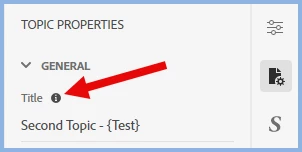

    Peter Grainge
    Nov 10, 2023 2:07 PM UTC
    Also you are referring to adding to the Book. I am adding the variable in the Topic Properties. That is where you will need it for the browser tab, when we can get your variables recognised in the first place.

    Is the New Variable Set dialog what you see when you click the + icon? Then when you click on a set, the + icon lets you add a variable?
    If not, how are you getting that Set dialog?
    Also have you selected a set in the preset?

    Looks like i see Variable Set. Yesterday when first testing i think we were doing Variables where you set the variable and a value. We selected the heading we wanted in the book for the variable and tried that. Without really knowing we did try both Variable Set and Variable in the Title both had the same result: Variable not defined.

    Peter Grainge
    Nov 10, 2023 1:20 PM UTC
    Adobe's online help does not mention Variable Sets, only Variables. That's why I want you to provide the information requested and see if my idea then works.

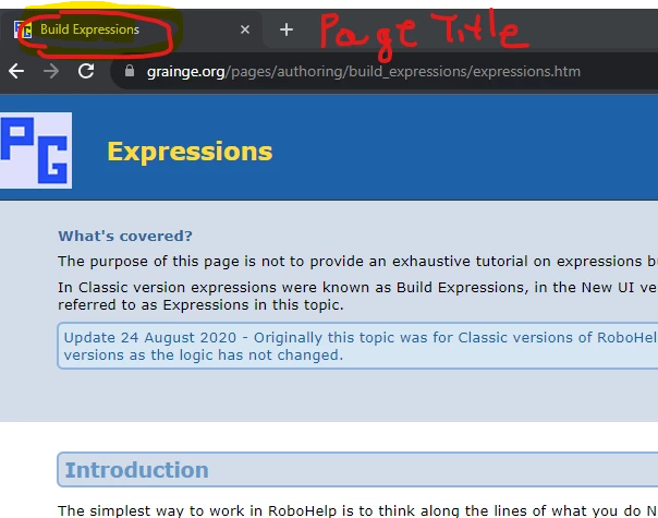

    NoSupportAuthor
    Nov 10, 2023 1:29 PM UTC
    Maybe variables is not what I am looking for. I visited your website and here is a screenshot from there of what i am trying to akomplish. The Page Title needs to match the Topic title. In our Book the Titles just stays the same as what the index page title is. Example: Welcome when we want it to say... Welcome - Topic Title

    NoSupportAuthor
    Nov 10, 2023 1:14 PM UTC
    This is what I have. Maybe Variables is not the right way about this. Its mostly about the HTML output and how that displays.

    Jeff_Coatsworth
    Nov 10, 2023 12:52 PM UTC
    Variable Sets vs Variables - missed that completely!

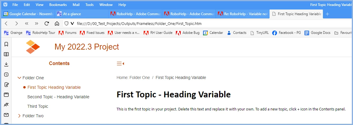

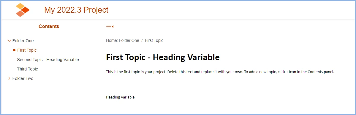

    Peter Grainge
    Nov 10, 2023 9:09 AM UTC
    I just ran some tests and this is what I see.
    If i add the variable to the topic as in the first image it shows in the Topic Heading. The topic heading is the same as the Topic Title by default but does not have to be.
    In the TOC you get the Topic Title. Here I added the variable to the topic title using CTRL Shift 9
    Click on the icon to see the shortcut.

    Nov 10, 2023 2:01 AM UTC
    I think the Frameless output shows the topic title in the browser tab, but if this is an existing project it might not be easy to swap (CSH calls for example would likely have to be changed in the application, if you're using it). But it's something to look in to if this is a new project. Additionally, Frameless seems to be where Adobe is focussing their efforts going forward.
    Peter's Robohelp Tour says variables can be added in to the Output preset field - it would be nice if this also allowed access to the Field variables, but I suspect it doesn't. It would be easy to check, I think - find out what the shortcut key is for inserting into a topic (it was Ctrl+3 in RH2019 but I'm pretty sure that's changed), and see if that shortcut works in the output preset Title field.
