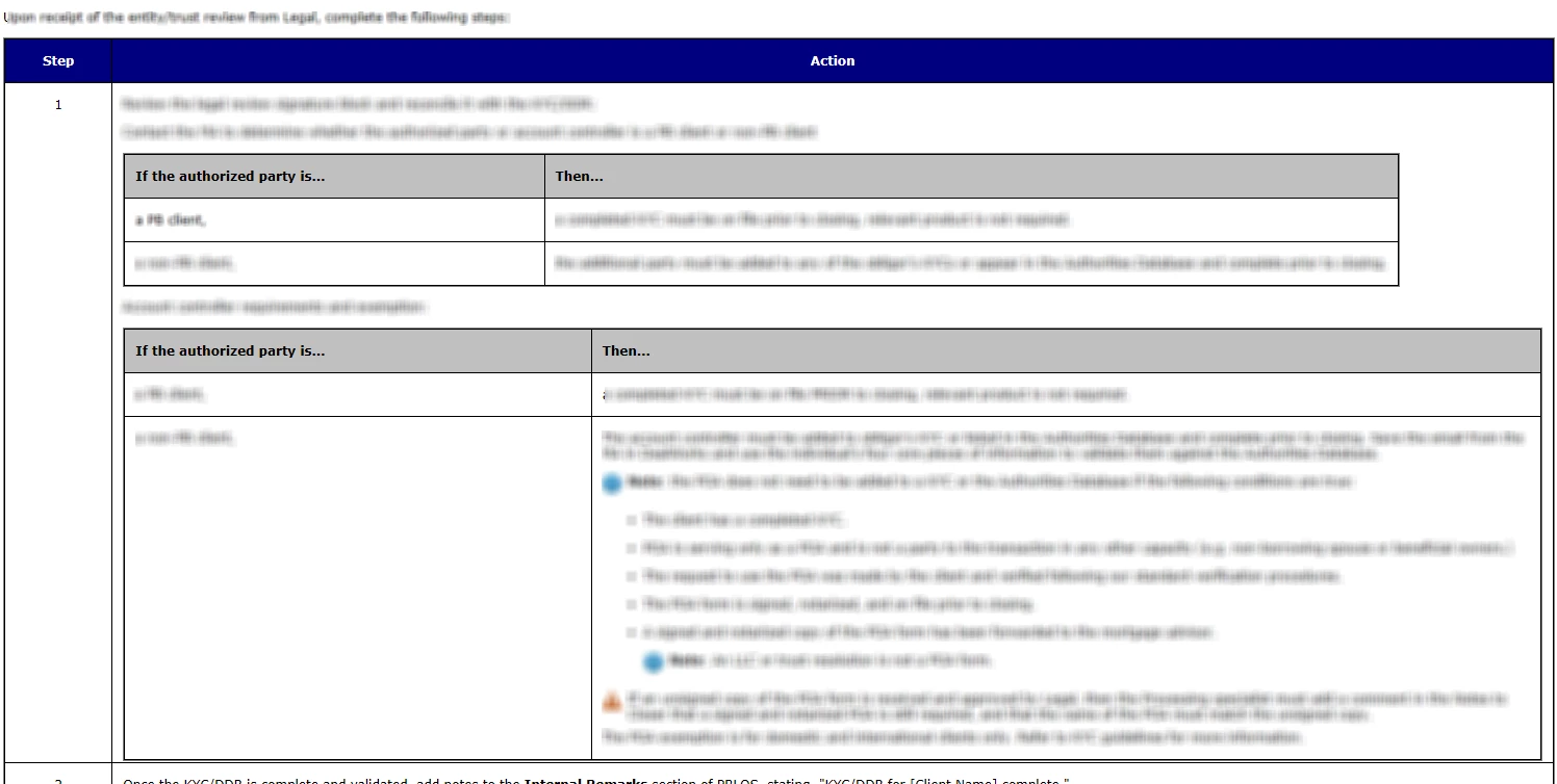

You're correct, it is just a matter of a different output format. What we do is use a snippet that contains the table we want with the formatting in it and when placing it in the topic we highlight the inserted table snippit and right-click and select "Convert it to HTML text." With the tables in our topics done this way there is no way to change the look of the table unless we use Table Styles or recreate the snippets like we want them correct?
Here is what we originally have as a sample table with embedded table:
Here are the tables created in a new topic using Insert -> Table. Everything works great except the first row (header) in the tables inside the larger tables should be gray even though the table style is defined gray. Also the embedded If/Then table style has the first row (header) defined as left justified, but it is ignored.
If I apply my table styles to the existing tables, the header row remains navy as shown in the first example and not in the lighter blue like I want and the If/Then table header centers which should be left justified. Because Table Styles weren't used in the first place, changing the look of these tables is really messy. I welcome any suggestions as to what is the best way to change the look of all these tables. We would like to be able to change their look in the future too. I hope I didn't make this too complicated to understand.
