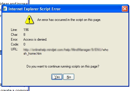

Script error when launching CS Help if same help window is already open
Mostly, I am enjoying using RoboHelp 8. Anyone else seeing this? This error occurs when the Context-sensitive help window (CS_remote) is already open, and the user presses F1 again.
If you click "Yes" here you end up with one empty about:blank window. It seems like the script gets as far as replacing the existing window contents with a blank window and then chokes.
Here is the code at that location in the script:

I am using RoboHelp 8.0.2.208 to generate WebHelp Pro. I'm viewing it with IE8.
I'm hoping there is a tweak to whcsh_home.htm that will fix this.

Finally found that this page (item #1) has the answer. The culprit is the whcsh_home.htm file. This has not been fixed in RH 8.02. The file posted on that page fixes the problem for me.
