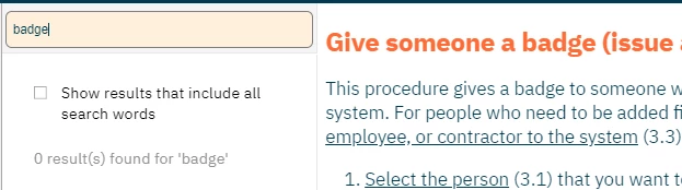

RH 14.0.9, new UI, Responsive HTML5 output.
When I search for some words that are clearly available in a topic, it does not find the topic (there are no stop words defined).
I even have added the word as separate search keyword, but to no avail.

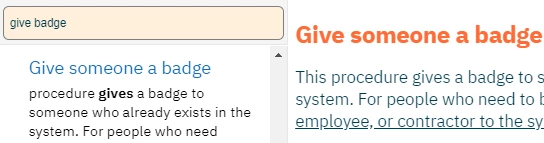

Other search words work fine. Note however that if I search for "give badge" it finds "give" but still not "badge".
I can't figure out why some words seem to be banned (I don't have any stop words defined)?
The word "badge" that I search for appears a lot in many topics, could it be that there are too many hits? But why does it give me zero hits then instead of "too many"? And why doesn't it find the word when specified further with another word? Or finds just the topic where it has been added as a specific keyword? Anyone know how the search algorithm works?

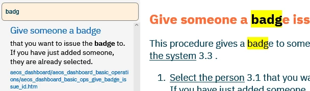

That's it! Searching for "badg" finds the topic. Thanks! I'll just disable search for substrings until the bug is resolved.
