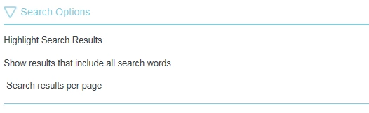

I am trying to output a HTML5 help file and am receiving the following error message:
It is also adding this search option to the help file, which didn't exist before:

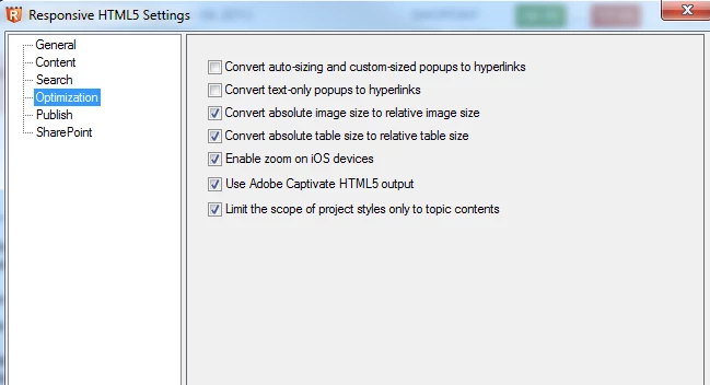

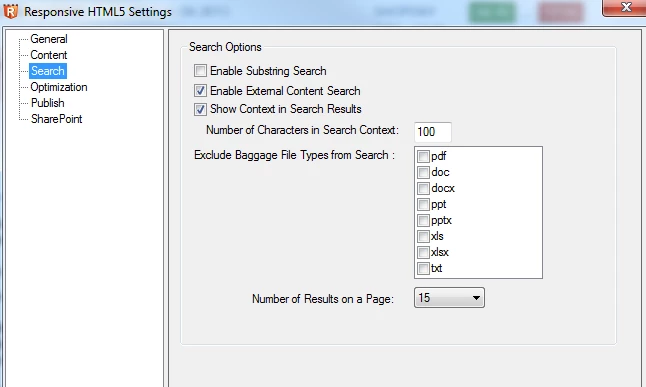

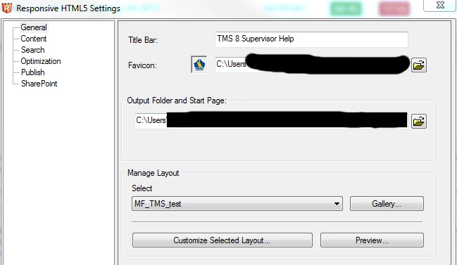

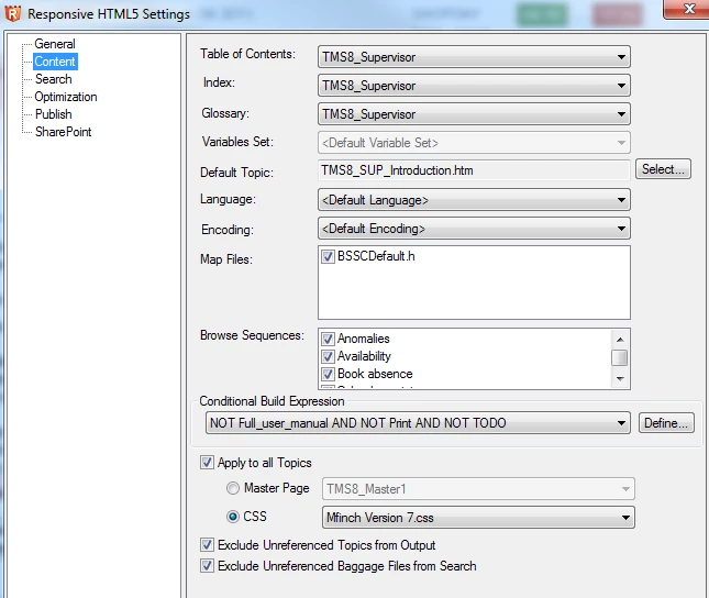

mitrefincha77665767
Oct 25, 2016 2:45 PM UTC
Hi Jeff and Rick,
Firstly, thank you for responding. I am indeed new to Robohelp, after previously doing battle with HelpStudio ('interesting' software), and so the explanations help a lot thanks
Both the output and the Robohelp file itself are stored on my local C drive.
Here are some screenshots of the SSL recipe:
Once again, thanks in advance for any help.
