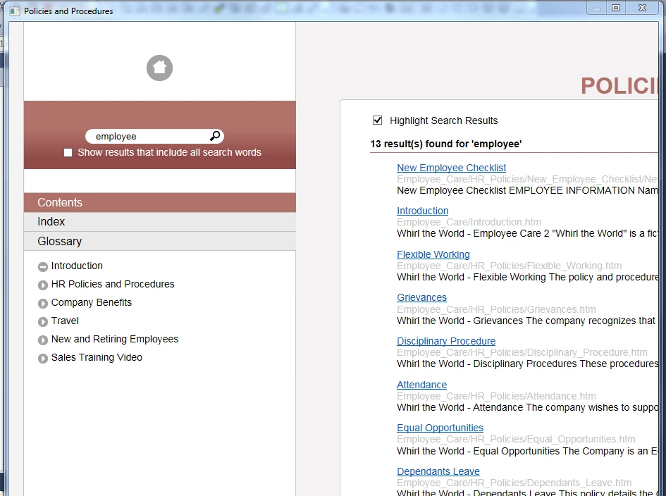

Here is a shot of the sample project, output to Multiscreen HTML 5. Same happens for the Salesbuilder2 sample project.
So your reply suggests that something is wrong with my application. What does that mean, and how can I fix it?
Jeff_Coatsworth
Jeff_CoatsworthCommunity ExpertCorrect answer
Nov 8, 2016 3:52 PM UTC
No, the answer is that you're using RH11 - without running RH2015, you won't be able to set the search results to appear in the left pane (like it used to do in WebHelp) without doing some deep programming under the hood to a custom HTML5 layout.
