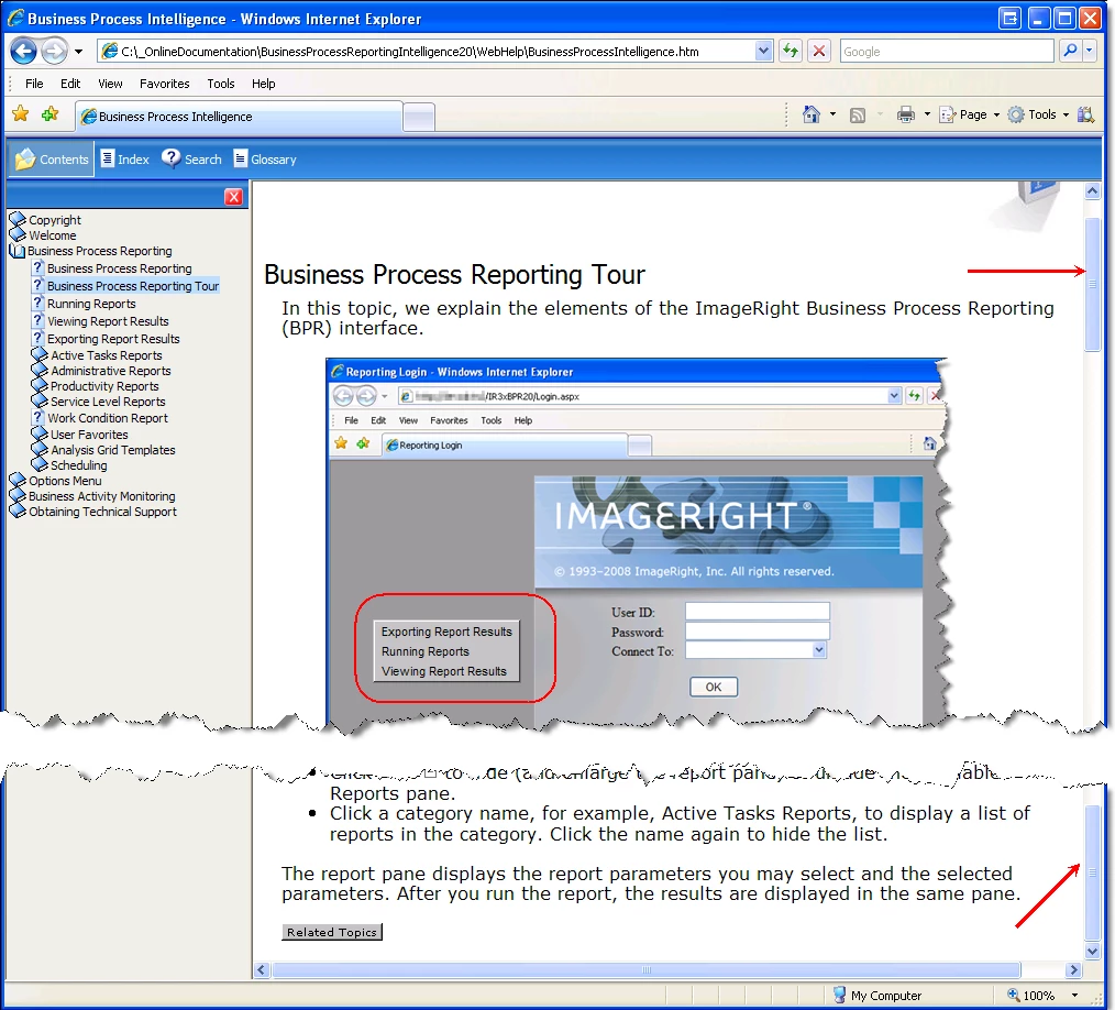

I need help with the See Also and Related Topics controls (buttons). The popup menu related to the controls does not appear next to the buttons in WebHelp. I can't see the menu without scrolling to the top of the topic. The need to scroll to see the menu means that the typical visitor will not see the menu, that is, it is not likely the visitor will scroll to the top of the topic to find the menu. Instead, the visitor will think the control is not working, as I did initially. I found the menu by luck actually.

To see the popup menu, I have to scroll to the top of the topic.
For an example, see the attached screen capture. Notice the position of the scroll bars in the top and bottom portions of the capture.

I see the same thing happening in my test project. Looks like a bug to me. I took a quick look at the output files, and there's a bunch of code that deals with how the popup menu is displayed. I didn't see a simple fix---perhaps more experienced eyes can see what to do.
As a workaround, it appears that if you select a "Topics Found" dialog box instead of the popup, that it will display in the correct location.
