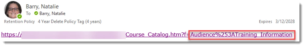

I have a project in RoboHelp 2022 publishing to Frameless that includes Conditional Tags that I have added as Dynamic Content Filters. We use these filters so staff can quickly find items that apply to their audience type(s).
The filters work perfectly in locating topics; however, I've run into an issue when users use these filters and then try using the email share option.
The URL that is attached to the email includes the Dynamic Content Filter selected:
If someone tries to use the URL that is emailed, it will launch the correct website. The topic details will display for a few seconds; however, it then disappears and states "This topic is filtered out by the selected filters". I'm not sure how to correct this issue and am looking for any ideas.

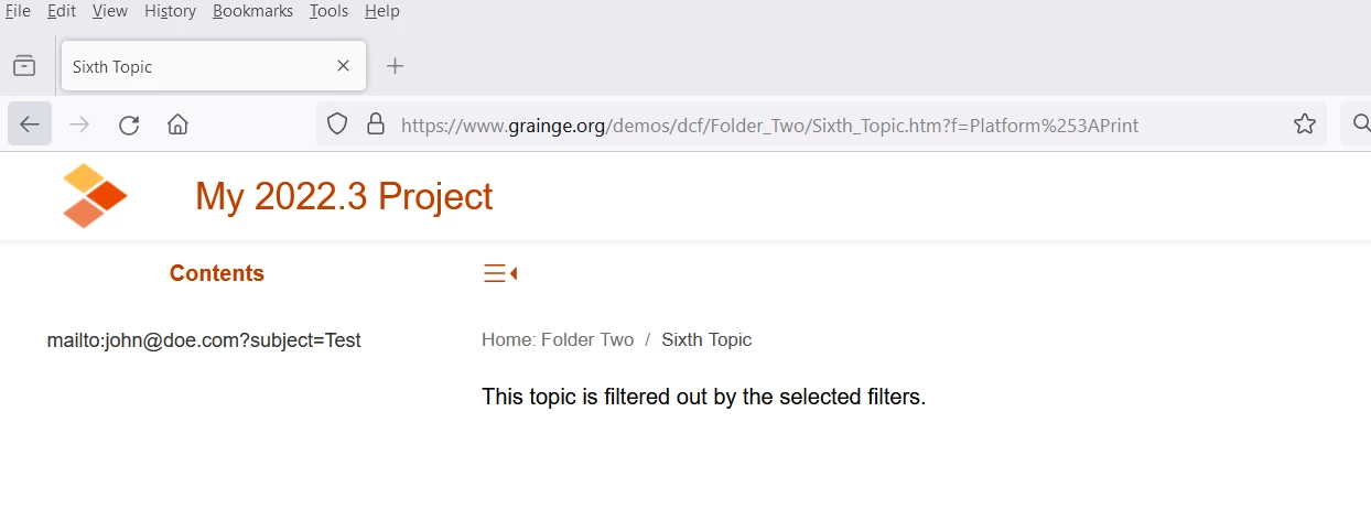

    Navigated to https://www.grainge.org/demos/dcf/Folder_Two/Sixth_Topic.htm?f=Platform%3APrint
    Did Share button - launches email - copied URL off email: (https://www.grainge.org/demos/dcf/Folder_Two/Sixth_Topic.htm?f=Platform%253APrint)
    Pasted URL in browser - gets message:
    Jeff_Coatsworth
    Mar 20, 2024 7:25 PM UTC
    Looks like that %25 is the encoding for the actual "%" percent sign in the original URL. Ah, but the original %3A is the encoding for a ":" colon in the actual command. So it looks like the script is not capturing the URL string intact as text, it's then encoding it again with the addition of the %25 in place of the original "%" sign.

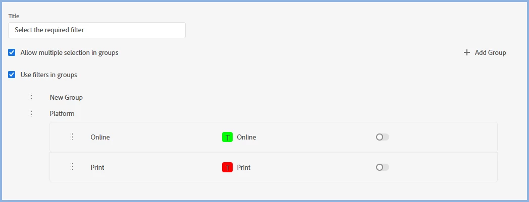

    My first thought when I saw your post was that it should work but when you showed it did not, my guess without testing was as I posted. However, I set up a project with three topics in each of two folders. In one folder the topics were tagged Online and in the other Print.
    My settings were as below.
