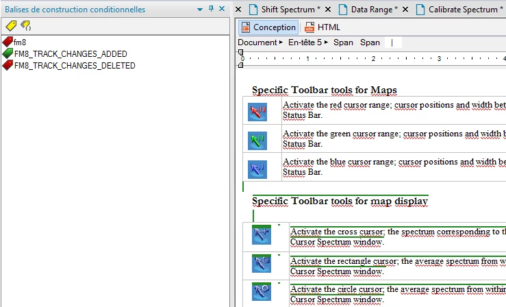

- 4 years ago I created a manual with FrameMaker (may be FM10, I don't remember) and created on-line help with RoboHelp.

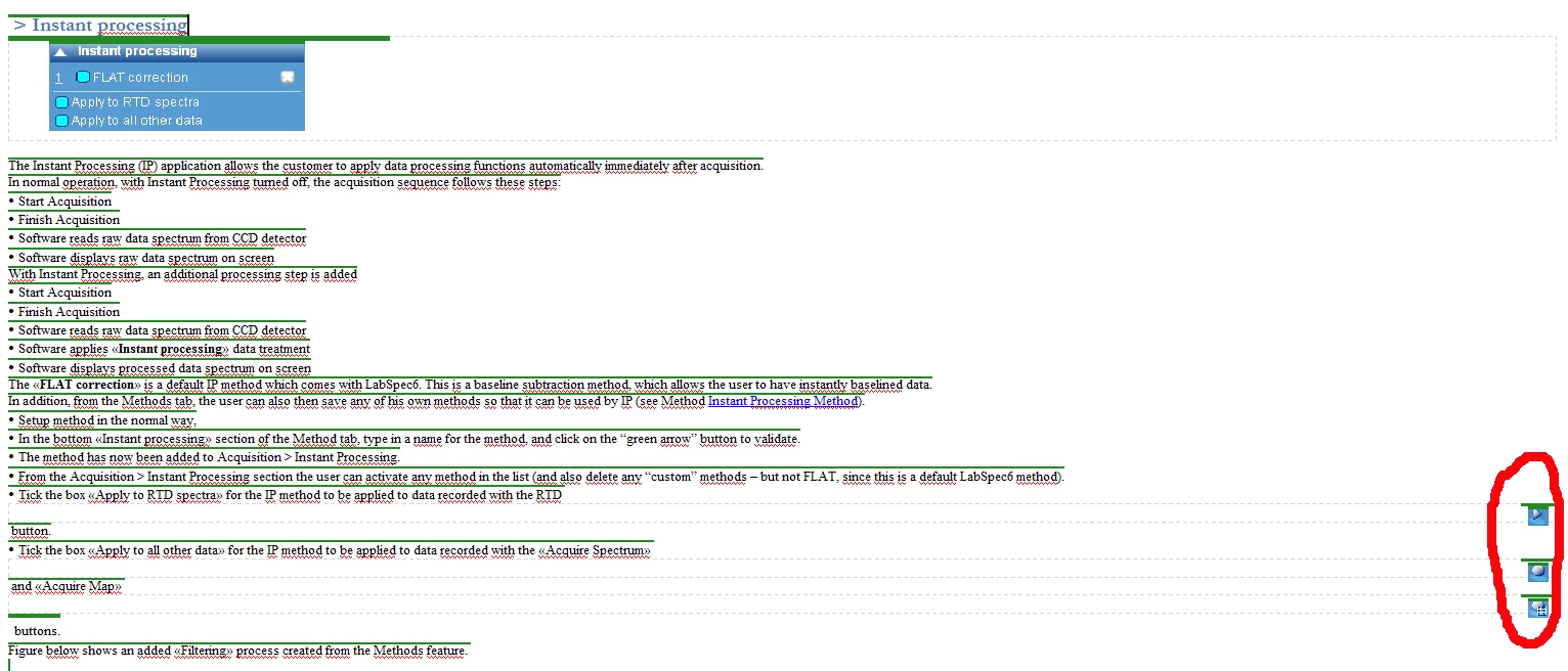

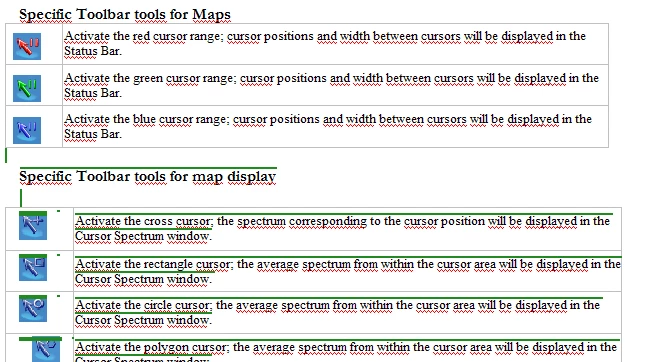

- 2 weeks ago, I needed to upgrade the manual and have added some parts with FrameMaker2015. Similarly, I imported this manual to RoboHelp2015 as a new project (I have changed my computer). The results was very strange: The new chapter located at the beginning of the manual was very fine and some old parts was fine too up to a specific line highlighted in green in the RoboHelp project. The figure1 shows the frontier: above the text and figures are not highlighted in green color and the text/figures are perfect: see figure2. All the manual below this frontier has some problems with images: they are shifted to the right, see figure 3. I have made the test by copying in fm the text with problem images to the beginning of the manual where no problem appears: in RH the results are the figure 2 and figure 3.

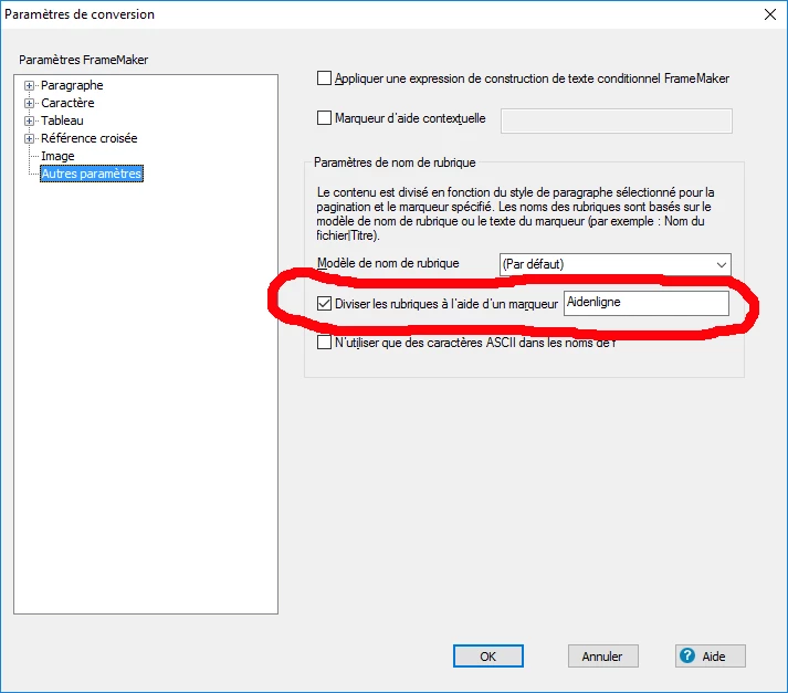

As a rule the FM manual is a source. From RH, I import the FM manual. Then in RH, I only change the paragraphs styles to have a good presentation for the on-line help files. To separate the headings in RH, I introduce a specific marker in FM document (here Aidenligne). The markers are detected by RH during the import process and separate the on-line help files. A figure shows the RH parameters for the marker name detection. That's all I do in RH.

Can you show a screenshot of the FM content where the issue is coming from in the resulting RH topic (it is the topic, right? not the output?)
