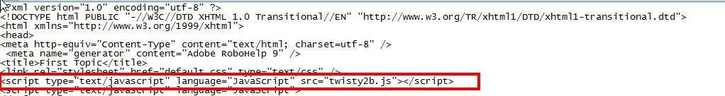

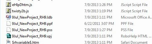

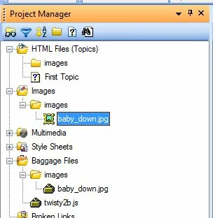

I tried in both RH 9 and RH 10 with a new project containing only one topic. I am still getting same results. I have attached the screenshots for your reference. Can you please check?
Modified image code:
Project Manager - Baggage files:
Modified twisty code:
Added JS code to the topic Header:
Twisty JS in Project Folder
Twisty JS in published folder

Peter GraingeCommunity ExpertCorrect answer
Jul 9, 2013 12:30 PM UTC
I am only seeing one image in your project. Although the user sees it as a one button method, there are two buttons, one for Show and one for Hide.
Show is the default and should appear in Images when you create the link. Hide is the one that needs to be in baggage.
Have you downloaded the demo rather than just the PDF?
