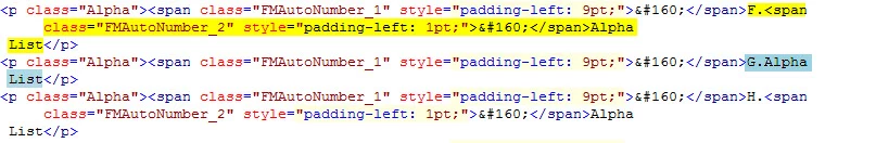

I'm single-sourcing my FM book into RH (TCS version 2015). I've auto-mapped my FM paragraph styles in RH, and in the Conversion Settings, told RH to Convert Autonumber to Text. This has worked perfectly, except for one weird thing: if I have an alpha list that extends to G, the space between the period and the following text disappears. When looking at the HTML for the list, it looks like this:
The yellow highlighted part is how it should appear. The blue highlighted area is what G is automatically converted to. It's in every topic linked from that FM book that has a long alpha list - not just this one.
I can manually fix this by adding that span tag, but that defeats the purpose of single-sourcing. I shouldn't have to go through all topics that have a long alpha list and fix this. Why is it doing this, and how do I fix it?

I see what you mean. In RH, all the letters (with the exception of G) have both FMAutoNumber _1 and 2 (by the way, my numbered lists have both as well). G is the only one that doesn't, despite using the exact same FM style as letters B through whatever. The lists seem to work with both FMAutoNumber _1 and 2 - I just don't know why G randomly doesn't include both.

What’s the FM source content look like for this section? There seems to be 2 FM_ autonumbering tags at play here.

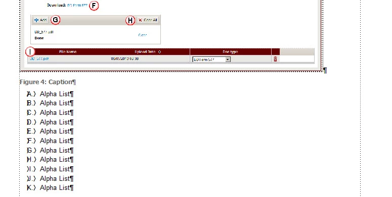

The FM source looks and acts normally. In FM, I have an Alpha1 style to start/restart lists and an Alpha style to continue lists. However, this shouldn't affect the G... at least I wouldn't think it would.

That’s what I was expecting to see, but if you look at each of F & G (H, etc.) you see that they all have mention of FMAutonumber_1, but “F” has FMAutonumber_1 and 2 – I would have only expected to see the “A” term in the list have FMAutonumber1 associated with it & all the rest have FMAutonumber_2 with them.
