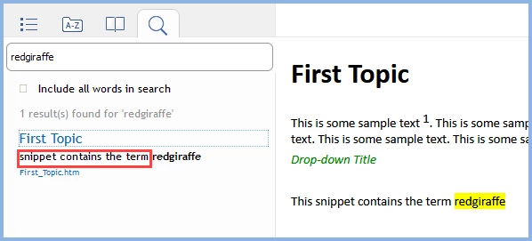

I have done a search of an output and cannot find any HTS files. I see the reference to an HTS file in an output but the path is the path within the source files, not the output. Have you searched and found otherwise? The thread you refer to is from an old version of RoboHelp so it is not relevant to your version.
The search term in my test was found in outputpath\whxdata\search_auto_map_0.js which is not a file for editing.
The test I did was for a simple dropdown and this is the result I got.
The term is found but you would not want it presented to the user in that way.
Nested dropdowns have always been a problem. I can only suggest you go back to the bug report and update it adding how the term is displayed in a single dropdown so that all the issues can be fixed in one go.
