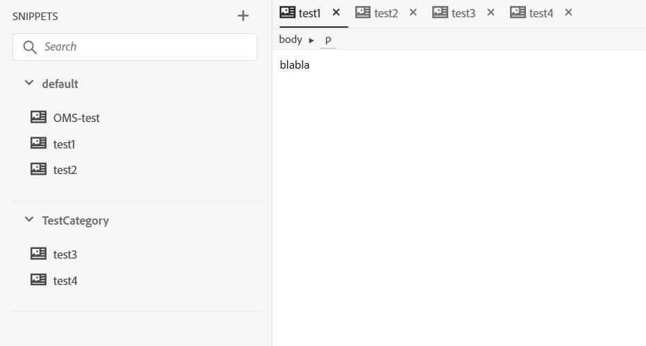

    Starting situation: I have 5 snippets, 3 of them in Default and 2 in TestCategory
    The dropdown to switch categories is confirmed to be useless as it does nothing:
    (upon reopening snippet, original category is shown)

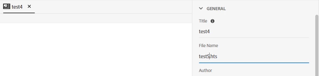

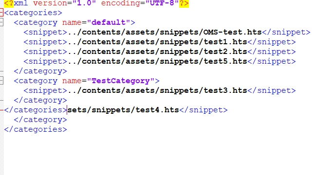

    I change the file name of test4.hts (in category TestCategory) to test5.hts. This causes the newly renamed snippet to revert to the Default category and cause test4.hts to hang around as a lopped off part after the <categories> tag, for reasons that the mortal mind cannot comprehend:
    (Fortunately, this does not cause RH to crash, yet)
    I revert the situation by adding test5.hts back to TestCategory and deleting the weird leftover test4.hts part.

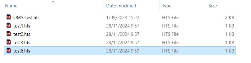

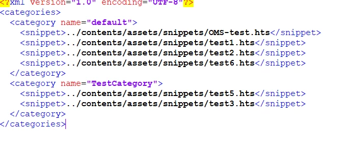

    I now edit the file name of test5.hts in file explorer:
    This indeed does not destroy snippetcategories.xml, so it's probably something else in my project.
    What it does do, is add test6.hts as a new snippet in Default category. I can understand this as this is editing something outside of RH. But it's something to keep in mind.
