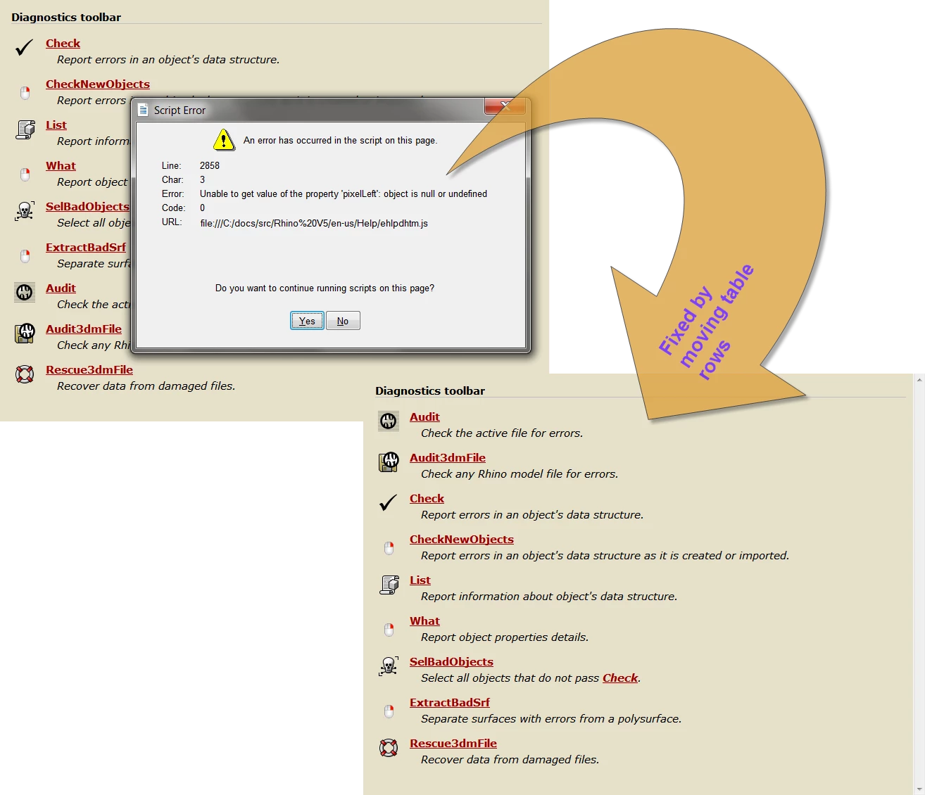

Well, I don't have a solution yet. I can't see a way to post the topic with its snippets, so if someone can help, I'll send you an example.
Sometimes I can solve this problem by shifting things around or doing some other simple things. In this case, if I move two table rows as shown in the image to the top, the problem goes away. When I move them back, the error pops up again. What gives? Anybody?

The problem comes from the DHTML effect you applied in the snippets. I removed the DHTML effects (in HTML mode, the toollbar didn't work) and the problem was solved in the example topics you send me. It did work in the output however with WebHelp. My guess is that's because RoboHelp correctly applies unique ID's in the output but not in the preview. It didn't work in your output? What are you creating?
