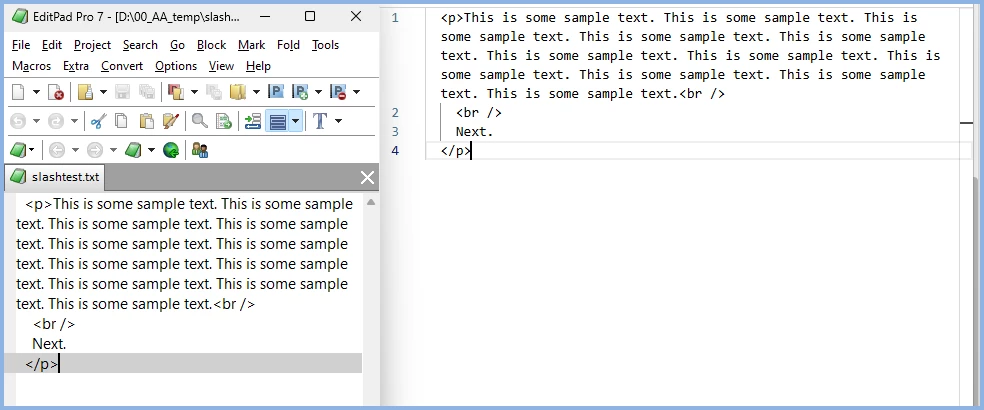

    Peter Grainge
    Feb 11, 2025 5:17 PM UTC
    Well I was going to ask but I prepared a text file showing a break tag with no space. Then I spotted the Explorer preview. Note the space. It comes back to different editors/viewers will show the tag the way they have been programmed.

    Peter Grainge
    Feb 8, 2025 10:28 AM UTC
    In 2022.5 I am seeing the tag created as <br />.
    • Close and reopen the tag it stays the same.
    • Remove the space, close and reopen the tag, the space gets put back in.
    • In a topic with <br /> and a link to another topic I changed the filename of the target topic but the space did not get removed.
    If I got the last step wrong, let me know.
    As your subscriptions entitle you to all use 2022.5 and you asked if the issue is related to different versions, I would say it is. You know what to do. 🙂
    Happy to run another test if it will help you.
