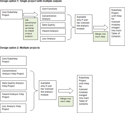

Where can I find information about the best way to structure a WebHelp project that needs to contain Help modules that will be accessible only to users who license the associated application? My project needs to contain core Help for the application and four modules associated with four licensable analysis program modules. I've done some research about merging Help projects, but that doesn't tell me how to set up the project or projects so that the user of program A, for example, can't see the Help for program B.

    Do you have any thoughts about how best to structure this type of project? Here are two design ideas I've been working on.
