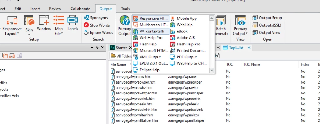

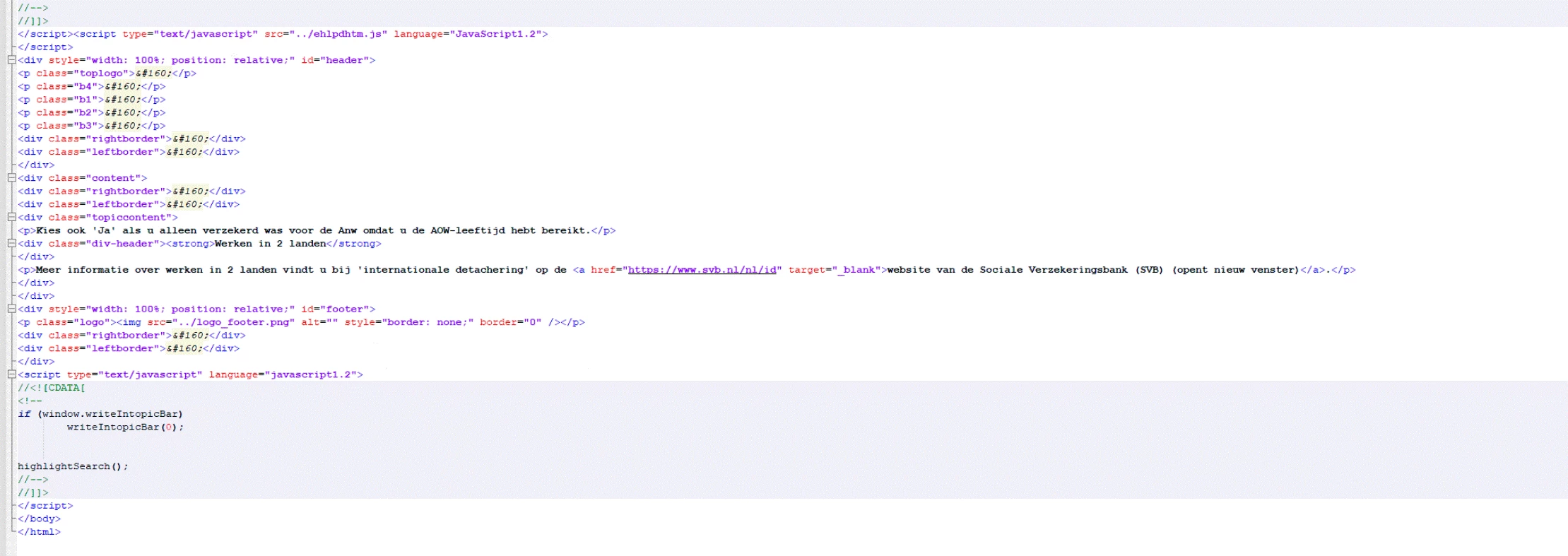

Yearly we make a new project by copy paste the project of the previous year and change the dates in the relevant files. This time some issues came up. We had problems with the variables. That problem is fixed eventualy by someone at Adobe. But now the styling seem to dissapear when I generate an output. The CSS files are coming with, but there is a lot missing in the htmlcode of the topics (in the output file) (see the attached images). Someone at our ict-department said to me that there service is looking for <div class="topiccontent"> within the html tag and using that part. And that part is now missing, so the topics are not showing at their end.
Where can I add this in the outputscript or somewhere else? I cannot put it manually in each topic, because there are alot (more then 800).

From what I can see of the code, the javascript stuff looks like webhelp output. It is the output you took a screenshot of, right? If it was a screenshot of your source, please let us know as this will mean you have a big problem.
The html in your "right" screenshot seems to be part of the body of the topic. Is the missing code a problem for every topic or only some topics - for example, only new topics you have added recently?
I apologise for the cryptic questions; I just want to get some further details so I don't start chasing rabbits down rabbit holes. 🙂

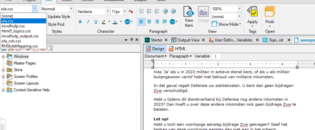

Indeed, the screenshots are of the output. But normally in the source a don't see this code also. It is always placed in the folder by generating the output (if i say it correctly). We only set up a css file when we are editing a topic (always ola.css).
The missing code is a problem in every topic.
