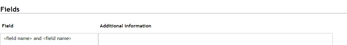

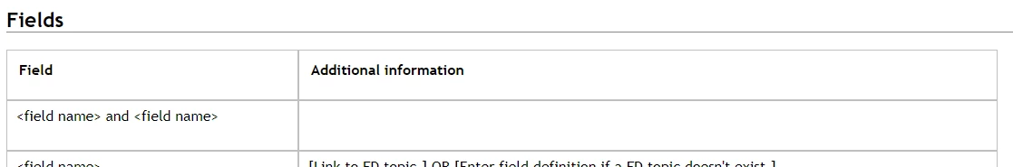

I am working in a project that was converted from RH2019 Classic and is now running on RoboHelp 2020.6.76. I have some table style updates I want to apply and these will work best if I can use the table header functionality. But right now when I click "Convert to Header" the style that is being applied is not the style I want.
This is what my table looks like right now with the header manually formatted using a paragraph style.
And this is what I see when I select "Convert to Header":
It keeps my formatting for the words, but the table loses its borders completely.
